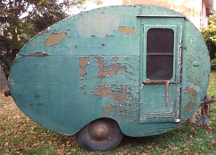

I'm more inclined to think the teardrop would end up looking like this someday...
That doesn't look good
Postby GeorgeT » Fri Oct 22, 2004 5:44 pm
That's what I was concerned about, the eventual peeling and fading of the paint. I retired from the sign business a couple of years ago. I've seen many old billboards that ended up looking like that. They were mostly painted with outdoor sign enamels (long ago they contained lead) heavily pigmented. Eventually they will fade and eventually fail. I know that a lot of sign fabricators started using acrylic enamels (car paint) to cover sign boards mainly because of the durability, fade resistance and nice finish and fast drying. I believe that most of this application was onto boards that had a sealer already in them or a thin laminate of some kind on the surface allowing for a nice finish with the paint. I was thinking that this paint might last much longer. Using cabinet grade birch might help with the grain as I have built many of my own home's cabinets out of the stuff and have applied only a sealer and a couple of coats of interior enamel without any hint of the grain showing. I will have to investigate further by calling up some friends still in the business. They do use an interesting material that might be used for exterior use. They use coroplast (corrugated PVC) sandwiched in between layers of thin aluminum. Some that I used was very strong and lightweight. Seems like I remember that the color was baked on enamel. Comes in varying thicknesses. Sign suppliers probably have it along with just plain sheets of different colored aluminum. Don't remember what it's called. I really like the Uniflex 255 stuff but it is pretty expensive. Almost more that the trailer costs. But still may end up using it as it is lightweight and easy to apply and pretty forgiving and won't delaminate or buckle in the heat.
