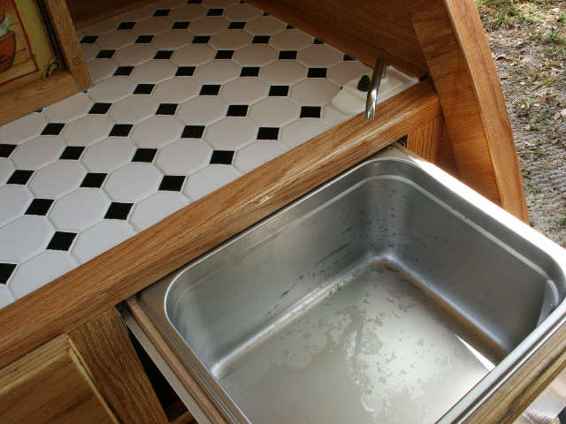

Postby b.bodemer » Thu Jan 04, 2007 2:08 pm
I went with a wood border around my counter and then tiles set within the border.............If I have any problems down the road I can slide the counter out. I'm happy with it.
Have fun with whatever you decide!!!!!! :)

Postby Miriam C. » Thu Jan 04, 2007 2:30 pm
Barb,
That is as pretty as the first time I saw it. Maybe I need to tile shop too. 8)
