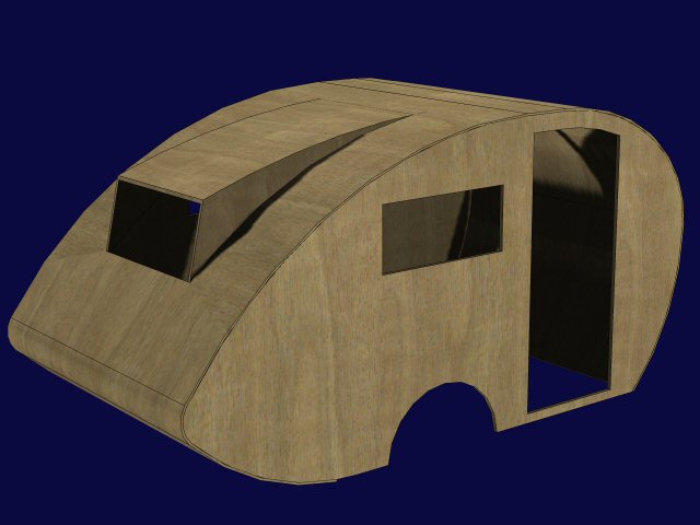

Here's my plan as of tonight...
Postby steve wolverton » Thu Jan 04, 2007 9:15 pm
mikeschn wrote:Here's my plan as of tonight...
:thinking: It looks like you designed a T@B. :)
�veni, vidi, vici.�

Postby mikeschn » Fri Jan 05, 2007 4:35 am
It's actually lower than a tab, and longer than a tab. It has the Lil Diner front end on it, and it has a tongue box that'll be attached to the main body, like the Ultra 550. The yellow profile lines on the back are swiped directly from the tab, and shrunk a little bit.
I have two floor plans, one with a bathroom and one without. So far I'm planning on building without.
Chell wants some diamond plate on it, so I'll make that piece under the window diamond plate. I'll also put those jeep rubber fenders on it.
We still haven't decided how to skin it.

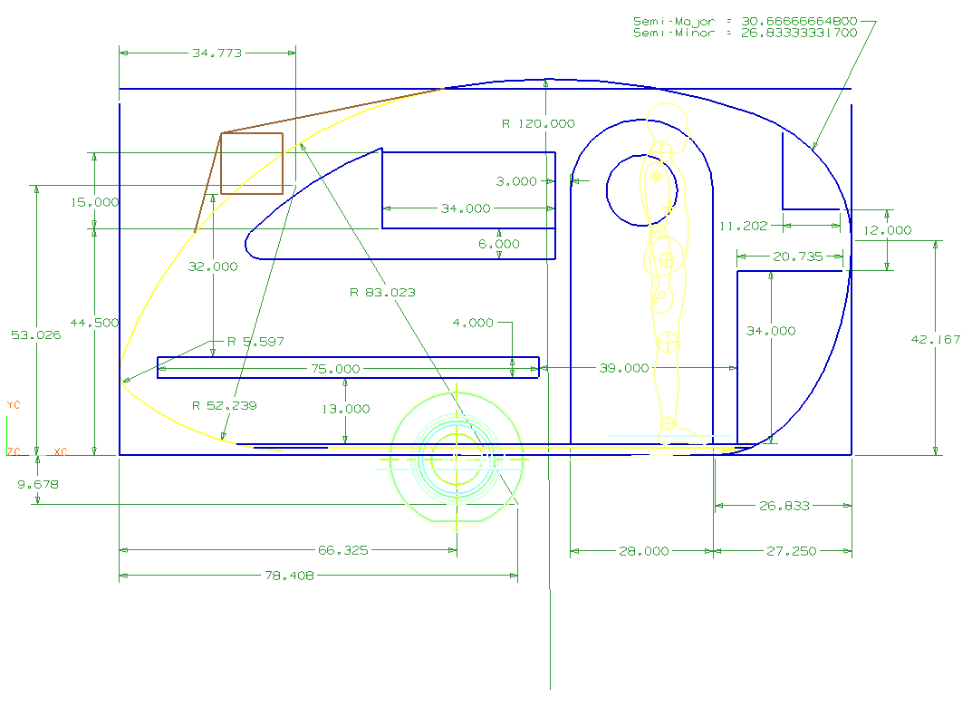

Postby mikeschn » Tue Jan 09, 2007 7:14 pm
Here's the Tab L design as it stands today... I've gotta thank Andrew for helping me tweak some important dimensions...

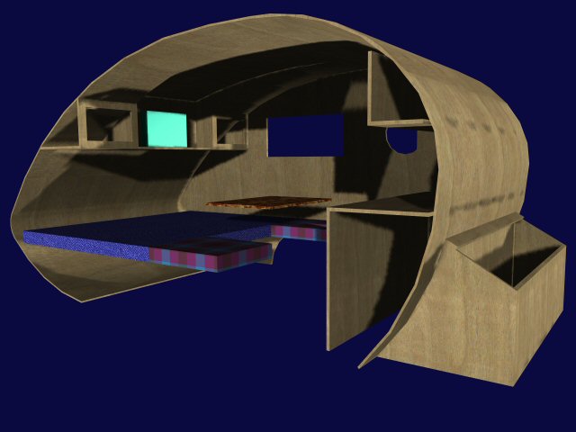

Postby mikeschn » Tue Jan 09, 2007 9:01 pm
Just did a little more playing around.
That's a queen sized bed in there, not counting the table. At night we could hide the table under the bed, to make it easy to jump into bed.
The tongue chest has a vertical wall in the back of it, to increase the storage space under the counter.
Yea, that's an air conditioner in the back, sandwiched between two cabinets.
Finally, all the space under the bed can be used as storage.
Did I forget anything important?

Postby bledsoe3 » Wed Jan 10, 2007 1:55 am
Mike, I do like the look but I just had one thought. What if you continued the back of the trailer down in a more traditional tear shape and made a rear access panel in the back below the bed (or sides behind the wheels). You would gain some storage space and avoid trying to make that tight radius.
