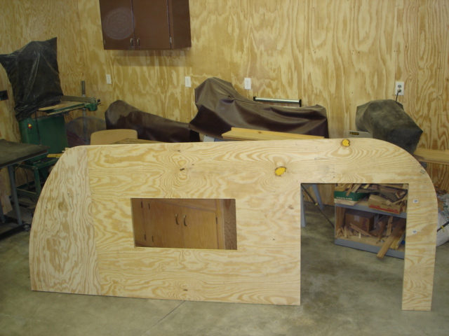

Found 16' and 20' roof/wall edge trim at RV shop, however, they do not think it can be bent around a radius.. looks much like the trim Grant sells (flat on top, rounded on side; like 1x1/2). Anyway, wanted to work on TD but if I can't "trim" it (aluminum sides, trim, etc.) and seel it then I will scrap the design and start over. I'd like to avoid 8' lengths so I can have a nice seemless roof and trim... any help would be appreciated... Here's a profile of my sides.

Thanks MadJack.. I'll go to HF and get one of those torches... I have lots of gas bottles. Hopefully I can find some 1x1/2 or so 1/16" angle... last I looked they had 1/8" but that seems a bit much to me. And you're right, learning a new skill is ALWAYS something I like to do - mine's about a 18"-24" radius on the front, that doesn't seem to extreem?

I can doooooooit... :lol: Well, I'm certainly going to try... I just got back from ACE, bought some 3/4 angle and a bottle of map gas... I made a radius, :shock: however, I wasn't securing it to anything, just laid it on there and started bending.. I'm guessing it's best to screw it down on top while bending it around, then come back to massage out the down leg. Building a jig sure seems like a lot of work, but I guess if it produces results then I should spend a day and make one ehh.. but I'd have to make 2, one for the front radius and one for the back radius :thinking: Thanks for the advise guys... this TD stands for "Tedious and Delicate" huh !
