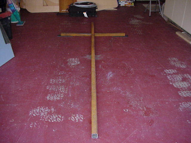

I'm from the point of view on this that most of these chassis are over built. Using all 2" tubing all the way around. The way I see it is we are building a teardrop trailer! Not a trailer for a teardrop. With that in mind my next tear is going to put the chassis and the tear together as they should be. http://www.tnttt.com/gallery/image.php?image_id=578
That's it. Not much else to the chassis itself. I'll use 1 1/2 wood boards for the outside frame rails. Other than that that's it. No cross members. No lateral support. No extra metal. What you see it basically it.
Going to use this design. A simple "T" type frame. The main beam is 2x2x1/4
The two beams going off the side are the same. The axles will be bolted to the two 22.5" side beams.
I'll use a 1/2 plywood floor and the whole thing will be solid.
Cost for materials so far 140.00 all I have to do is get the axles which I hope to do in the next few weeks and weld it up.
Bufordt :twisted: :twisted:
P S so in answer to your question. If you are not going to rock crawl your tear. No need for a heavy duty chassis

That about covers it Andrew. Except I don't believe that you need the cross braces nor the steel square tube around the outside.

Agreed. And while we're having the "mine's lighter than yours" boasting contest, I'd question whether a strong central tube is as efficient as two angled chassis members:
Same weight - just spilt the 2" tube into two 2" angles.
Andrew

Postby BrianB » Mon Nov 01, 2004 12:36 pm
My main concern with a t-shaped frame is the lack of bolt points. I'd prefer to be able to bolt my wood frame down at each corner as opposed to having a a single anchor point in the center of the trailer. If you're sleeping alone on one side of the mattress, there will be a lot of stress on that one anchor point.
I'm going to be getting the trailer made in the next couple of weeks and I'll probably use the 1" square tubing on top of the angled chassis members. I'd be hesitant going under 1.5" square tube, but it looks like that 1" tube is pretty sturdy.
Of course, that 2" drawbar down the center is a great place to store the fishing rod like the guy in the Mechanix Illustrated article did. :)

Postby BufordT » Mon Nov 01, 2004 1:21 pm
BrianB wrote:My main concern with a t-shaped frame is the lack of bolt points.
BrianB,
I'll be using angle Iron 3 ft from the end of the tongue. Two small ones that I'll be able to attach the 1 1/2" sq wood to. then I'll use two small angle irons on the ends where the axles go. That will give me the support I need for the sleeping area.
You have to remember that when building these trailers from what I've read and learned over the past two years it that all the stress and all the support is above the kitchen area.
Bufordt :twisted:
