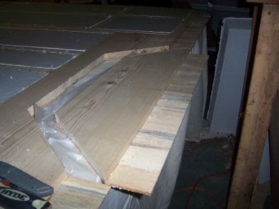

Hi all,
Well, I don't know where my brains were but I managed to layout two left walls. In other words. I put the wheel well on the second wall in the same location as the first. We've cut out the 1x2's and have put in a wood filler in the places where it dug up the 1/4" ply. For the new location of the wheel well. Thankfully it was only in the first board of the ply.
Here's the problem, we have to fill in the hole we created in the misplaced wheel well. We have the pieces we cut out from the plywood and the 1"x12" pineboard that we used to go over the wheel well. I've glued the 1/4" ply to the pineboard cut out.
We're thinking of using liquid nail to reattach the piece we cut out. Is that plausible? Will we need to cover with fiberglass on the outside? (Or some other covering?) Would Titebond III mixed with the sawdust create a stronger bond?
Thanks in advance for all your advice.
Lynn & Paul

Miriam C. wrote:Lets make sure I understand, you are going to use the cutout to fill the misplaced hole and back it with 1x12 pine??
Okay, I'm not making myself clear, sorry. I've uploaded to pics, I hope these will help.
With regard to why the walls are not the same is because they are 1/4 ply, framing with an interior wall of 1/4 those the inside wall is opposite of the other wall.
Here's the link to the picture with the wheel well cut out, this is the one we put in the wrong place. Image
You'll see the pieces we cut out are being glued together and I hope to insert them back into their original place.
The second picture is the new location for the wheel well and you'll see we've cut out a new 1x12 and removed the frame. We're waiting for the patch we added to the plywood to dry before we cut the 1/4 ply with the hole for the wheel well. Image
Hope this helps.
Lynn

Postby halfdome, Danny » Tue Feb 13, 2007 5:51 pm
One way would be to get a spline bit and route out a slot on both sides of the offending cut. Cut 1/4" plywood splines to span the slots you routed in each piece (less 1/16" for glue) and glue and clamp it back together. You'll need to cut a strip to band the bottom edge because it will be short from your original saw kerf. I would definitely use a Gorilla type glue for this re-joining of parts. Another way would be to rebuild that wall. :D Danny

Postby Miriam C. » Tue Feb 13, 2007 5:59 pm
halfdome, Danny wrote:One way would be to get a spline bit and route out a slot on both sides of the offending cut. Cut 1/4" plywood splines to span the slots you routed in each piece (less 1/16" for glue) and glue and clamp it back together. You'll need to cut a strip to band the bottom edge because it will be short from your original saw kerf. I would definitely use a Gorilla type glue for this re-joining of parts. Another way would be to rebuild that wall. :D Danny
:o I guess I should wake up and pay attention. You will have a gap on 3 sides from the saw kerf. A filler and some fiberglass or a backer or both will make it right. Or like Danny said do a spline on all three sides, extra wide and fill the gap.
Will you still need the 1x12?
Postby asianflava » Tue Feb 13, 2007 6:18 pm
Cutting out 2 of the same side is pretty common. I made a big effort to avoid that by writing "inside/outside curb/street on each side. I still managed to mess it up. Luckily, it was on the outside skin that was going to get covered with aluminum. It just meant that the smooth side would face the aluminum. I wanted the rough side to give the glue more tooth to adhere to.
The piece you cut out will be a tad smaller due to the saw kerf. You may want to cut out a new piece rather than use the old cutout. You may also be able to use pocket screws to help the adhesive clamp the piece.

Postby Keith B » Wed Feb 14, 2007 10:13 am
Lynn...what a bummer :roll: ...but don't get discouraged - anything can be fixed. You have the skills and there's TONS of knowledge on this site to give you tips on making the repair. Think of the end goal, not of the immediate mistake. Danny's idea is good - splines are strong. Dowels are also strong. You could also lay the patch in the opening, trace out and area that goes 6-7" into the wall on both sides and completely through the patch and lay in a piece of wood into a routed out cavity, glued and scewed - basically creating an inlay; sand the patch down then cover and feather both sides of your wall with leveler, let dry and sand smooth (much like doing drywall) - you'll hardly notice it. I'm not a fan of Gorilla glue, but it is strong. I'm a TiteBondIII guy - 3000psi stength, longer open time, easy clean up, waterproof.... any "good" glue will work. Take your time and it will be great. :thumbsup: OH...and TitebondIII mixed w/ sawdust does not make a stronger bond - it makes a great "putty" for filling holes - just use whatever glue you use right out of the packaging.

Postby madjack » Wed Feb 14, 2007 11:45 am
Lynn, regardless of what kinda glue or patch you end up using, a spline, bisquits or pocket hole screws should be used as well

Postby halfdome, Danny » Wed Feb 14, 2007 12:04 pm
Lynn, The reason for suggesting Gorilla glue is it's gap filling capabilities. I usually use any of the Titebond glues depending on what I'm dealing with. :) Danny
