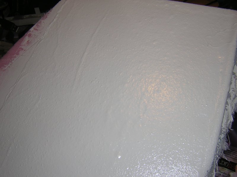

The technique is to apply a thick coat of house paint to the side of the trailer than press some kind of cloth into the paint and add a couple more coats of paint.
The gentleman at LCG said that he had made boats this way so it should work on trailers.
Here is what the finish looks like on a piece of 1/2" foam
I found an added bonus to this. Try this with a piece of 1/2" foam.
Yes that is bent double and it doesn't seem to effect the out side finish except for some gatoring of the paint and there is no apparent damage to the foam.
GAry

Actually this is still in the thinking stage. I'd shared it with Mike but that's all. The trailer I saw it on used it over plywood which makes it more punchure proof. with the foam you can hit it with a hammer and all it does is dent the foam but it cuts easily with a knife so I'm sure a sharp object would go through it. You might could glue the foam to 1/4" plywood and use the paint and cloth on the outside.
