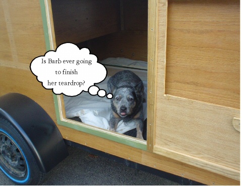

My sides are 1/2" also. The pic below is a good one, even with my dog is included, so you can see the way I trimmed the door both inside and out. At this point I han't put the window in yet.
The trim is 1 x 2's both in and out around the door. Makes plenty of room for hinges, stiffened the door, and worked perfect for installing a regualr door knob.
