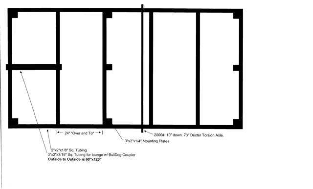

This is the trailer design:

Keith, your design looks like it's a bit heavy. At the very least you can loose one or two of the cross members.
I'd probably go with a 2000# axle if I were you. Something that tells me you will have a heavy trailer. :roll:

Postby Keith B » Fri Mar 02, 2007 4:28 pm
Yeah you're probably right... 2"x1/8" sq. tubing should come in at .256# per inch... if I went 10' down both sides (20'), 10' for both ends, 15' for three centers...45'*12"=540"x.256=139#, plus axle, wheels, tounge, hitch, fenders, etc....300#s thereabouts......man...if I only have 2 stringers in there that's 37" between each... that's a pretty big span for wooden 2x2's and 1/2" ply isn't it... :thinking:
