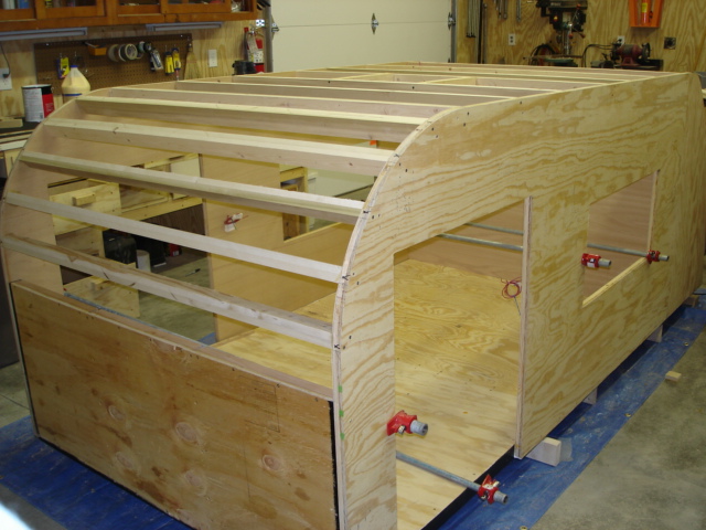

Hi all,
We have a quarter curve on the top of the Inkwell. We have a 1/4" luana(Which is slightly less than 1/4) and can't bend it around the curved sides.
Do we need to steam the wood? Can we just soak the wood in a pool?
Should we purchase a 1/8" luana? If so how do you glue the two sheets of luana together? Do we need to make a mold?
Let me know how you all have handled this, I'd hate to cut those beautiful matching curves off and angle them straight as we originally had planned.
Thanks for the help,
Lynn & Paul

Lynn... Having looked at your album pix... That is a pretty tight radius for bending 1/4" luan methinks. First off I would suggest you add a spar at the center of the radius on both ends to give you something to bend it around better. If you have trouble using 1/4" ply, you can get 1/8" luan doorskins at most big-box stores cheap. They come about 3' x 80" size to recover most doors. So, I think they would work fine for your TTT. You can use cargo straps to hold them in place while your glue dries. Laminating two plys is a good idea too... add the second ply after the first one sets up movernight. I'd prolly use PL urethane glue for bonding that second layer. It comes in a caulking tube. You can also wet the doorskins and roll them up with the cargo straps to "pre-bend" them a lot even before you cut out your pieces to glue in place... letting them dry overnight.

That's a pretty tight curve... I'd probably go w/ two sheets of 1/8"...I had to on my back curve because it was a little to tight.. If you bend ply to tight and hear any cracking or see splitting you've split the fibers, which eventually w/ time will seperate the lamination w/ humidity, etc.. thus you need steam or something like MadJack told ya..GO SLOW...if you use 2 sheets of 1/8" and even if you get a little ridge, you can fair it out w/ some epoxy later... I would use a backer board when glueing and screwing down and use a waterproof construction adheasive and let 'er sit for a couple days... if you check out my album you can see the "backboard" I'm talking about when I did my roof, you just have to fill the screw holes later... no big deal. I used Leech F-26 - Liquid Nail is very similar.

Lynn... I just looked at your album again... your curve is prett tight...but I don't think you have enough spars in the curve area... personally, I put my spars 6" apart on a 2' curve and 3" apart on the back, a 7" curve... I might not see them in your album...but you need spars in the curve, otherwise the plywood is going to try and follow then "bend" on your walls, but in the middle where there are not spars, it's going to want to straighten out and/or pop up, and you have NO gluing surface....as you probably know, and are worried about, the curve is crititical to have tight and secure which means you need glue surface... I'm sure the more experienced guys can tell you exactly what needs to be done as far as spars...but I'd add at least 2-3 in that curve area. Guys.. you might look at his album to make sure I'm giving correct advise...if I'm not, I'll delete this post and slap myself for speaking out of turn... :lol:

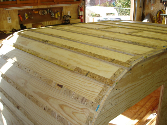

Lynn: Here's a photos of my spars in place... again, my space was 6" apart on the 2' curve, 12" apart everywhere else and 3" apart on a 7" curve (back)... I used 1/4 everywhere except at the 7" curve, I then used 2 sheets of 1/8", applied 2 days apart. The height difference between the 1/4" and the two 1/8" pieces is MINIMAL, and will easily be faired out w/ epoxy later. My album has more photos of the install if you care to peak at them.

Keith B wrote:Lynn... I just looked at your album again... your curve is prett tight...but I don't think you have enough spars in the curve area... personally, I put my spars 6" apart on a 2' curve and 3" apart on the back, a 7" curve... I might not see them in your album...but you need spars in the curve, otherwise the plywood is going to try and follow then "bend" on your walls, but in the middle where there are not spars, it's going to want to straighten out and/or pop up, and you have NO gluing surface....as you probably know, and are worried about, the curve is crititical to have tight and secure which means you need glue surface... I'm sure the more experienced guys can tell you exactly what needs to be done as far as spars...but I'd add at least 2-3 in that curve area. Guys.. you might look at his album to make sure I'm giving correct advise...if I'm not, I'll delete this post and slap myself for speaking out of turn... :lol:
Hey Keith,
Thanks for taking a second look. You're right there are no spars, yet. :R
We plan on having some 3/4 ply curves in the middle, 2 more per curve. Which will be slightly more than 1.5' between each curved piece. Do you think we'll still need spars with that short distance?
