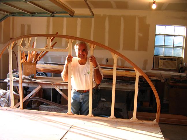

Postby mikeschn » Thu Mar 08, 2007 7:28 pm
Is that (the second picture) and this (the first picture)
one and the same... it sure looks different. How much does it finally weigh?
jplock wrote:I also went with House Paint. I uesd Kelly Moore's Best Latex Primer 3 coats and two coats of the best latex House Paint. I have stored mine inside so far. All the coats were applied with 1" Knap roller, and made a nice textured finish.

Postby Arne » Thu Mar 08, 2007 10:46 pm
JPLOCK: How did you build your wall's perimeter curved frame.. I like that and would like to try something similar.... Your wall looks light and sturdy. very nice.
