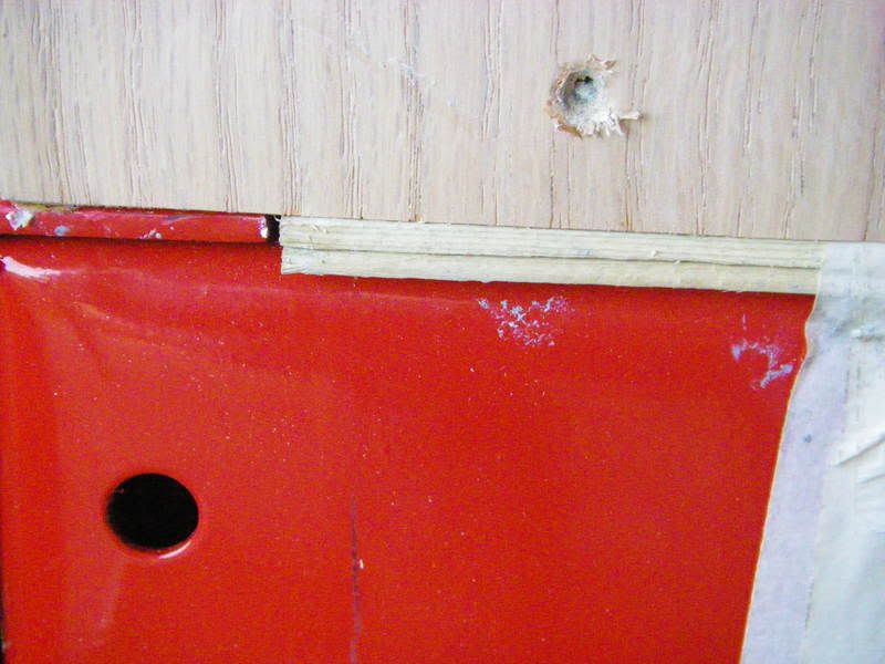

Floor spacers.
Postby ahjones3 » Wed Nov 10, 2004 1:04 am
I cut my 2x2 floor joists from pressure treated 2x4's. After ripping out the 2 -2x2's, I was left with a strip slightly less than 1/4" thick x 1 1/2" I glued these strips to the cross members with Gorilla glue. After the glue dried, I planed them down a hair with a little block plane to the perfect thickness.
Al.
ahjones3
Posts: 44
Joined: Fri Sep 24, 2004 11:23 pm
Location: Suburban Chicago
made my spacers
Postby GeorgeT » Sat Nov 13, 2004 12:23 pm
I went ahead and cut spacers by ripping 2x2's on a table saw. I gauged each spacer for thickness and ripped accordingly. They varied a bit in thickness from one crossemember to the next. Drilled holes in the spacers to match the holes in the crossmembers and then glued them to the frame using silicone. Looks like it will work. Cutting the flooring today. :)

Postby Randy77301 » Thu Dec 20, 2007 1:31 pm
dang this is an old thread....
I found the latice strips at Lowes and used them for that gap on the HF trailer......
