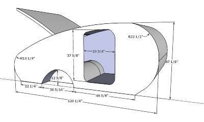

Postby Airspeed » Sat Mar 10, 2007 10:12 pm
Hello, I have revised my plans several times, I was going to build it 6' wide but discovered my shop door is only 5' wide. any way you guys can have a look and point out my mistakes! Thanks!

Postby Miriam C. » Sat Mar 10, 2007 10:19 pm
:( I hate popping bubbles but howrya gonna get it out of a 5' door way if it is 4' wide. You still have fenders and wheels and axels :?
Perhaps you can build all the parts and assemble it outside the shop. :)

Postby Airspeed » Sat Mar 10, 2007 10:26 pm
Fenders and wheels come off and go back on when its out. actualy the door is 5'6" . I will roll it out on casters and mount tires outside

Postby Airspeed » Sat Mar 10, 2007 10:29 pm
The body will be 5' wide, I was going to build it 6' and flush mount the tires.
I would still like to flush mount the tires but I'm not sure how it would look on a 5' wide camper, Thanks, Aaron

Postby grant whipp » Sun Mar 11, 2007 6:56 am
Airspeed wrote:The body will be 5' wide, I was going to build it 6' and flush mount the tires.
Hey, Aaron!
The Tourrer/Tourettes (late-'40s-to-early-'50s vintage Aluminum teardrops) were 5'x10' with the wheels inside the body and they look just fine. KampMasters were about 6.5'x12' and had the wheels inside the body, also looked just fine. You've come up with a nice profile, and I don't see any reason your's wouldn't look just fine as well!
If you don't mind, I'd like to suggest you make your entry door a bit wider ... something in the 30-32" range seems the most desireable and functional.
Kevin's right! Build your trailer 6' wide like you originally planned, then turn it on its side to get it through the door.

Postby Airspeed » Sun Mar 11, 2007 1:15 pm
Hi, I live in FallRiverMills, about an hour east of Redding.
I think I may just go with a 5' wide body, The money saved will allow me to use better quality materials. Thanks! Aaron
