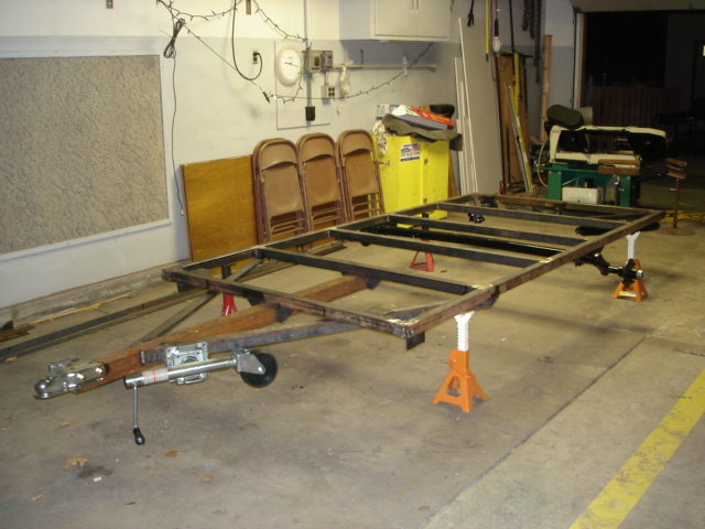

Here are my chasis/trailer specs.
Perimeter and 1st inner-most crossmember - 2x2x1/8 tube steel
Stringers - 2x2x1/8 angle on 2' centers
Tonge/Straight - 3x3x1/8" tube steel
A-frame members - 2x2x1/8 angle
Tonge from front of 1st crossmember to center of ball - 43"
Axle position - 46" from rear
The frame looks great :D ...BUT, as it sits in this picture...if you push down on the tongue, you can see the whole frame flex "up" :roll: and/or bend - more than what I wound have expected... is 2x2x1/8" tube enough for the perimeter, should I start over or will the "box", a/k/a TD body, keep this from happening.? should I add stiffeners somewhere, extend a piece back to the 3rd stringer, etc :thinking: .... I thought this was more than stout enough and maybe it is for 8' but maybe not for 10'...for the first time on this forum I wonder if I "under"-built; :oops: What did everyone else use for frame on 5x10 TD?... I'm more than willing to go buy all new steel (heavier) and start over....but as you can imagaine, I'd rather not... but I do NOT want to compromise... it looks so good, really, and the wheels and tires are gonna look great... I'll post pictures of those tomorrow after it's rolling, if I don't rebuild.

I'm certainly not an expert on this, but when you put your 'box' teardrop body on there, I don't think that you will see any flex at all.

Don’t worry the body will stiffen it up. :thumbsup:

I concur... don't sweat the flex at all. Once the box is on it it will be more than stiff enough and plenty strong for a tear. :thumbsup: :thumbsup:

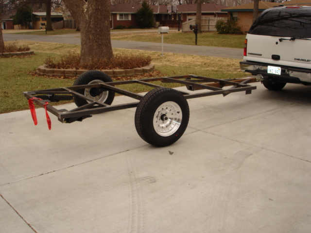

Add one more in agreement with the previous replies. Mine is a 10 footer with 2X2 1/8", just like yours. Yes, it flexed until the "box" was installed. You are on the correct path. Keep on going. Your frame looks great.

Postby Keith B » Sun Mar 11, 2007 5:32 pm
Well... one can't go wrong with the experience of this forum, and I'm sure it's overbuilt now after seeing some of the contenders :lol: ... I finished up the welding, added the goodies (stablizers, tongue wheel, tires and rims)... I took er on a 40 mile test run and to COOP for weight... 400# complete and 60# tongue weight. Driving was anywhere from 0-80 and there was ZERO sway... quite happy :D . Considering the HF red trailer (4x8, small wheels, etc.) comes in at 275 I'm very please w/ 400#s. Here she is...prep, prime, paint, lights, etc. to follow.
ImageThanks for the all the great help guy !!!!!!!!! :thumbsup:
