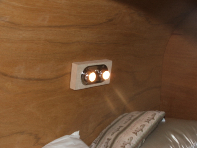

Gerald, The luan I used doesn't seem too dark. Look at the wood on the outside of the light box. It is unstained versus the wood on the wall that is stained.
Just a contrast shot. I did stain it to match.
