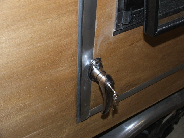

Postby bledsoe3 » Tue Mar 13, 2007 1:23 am
SR9, Here's a couple of pictures of the t-moulding (exterior seal) Jack mentioned.
More in my album. http://tnttt.com/album_ ... er_id=1098
