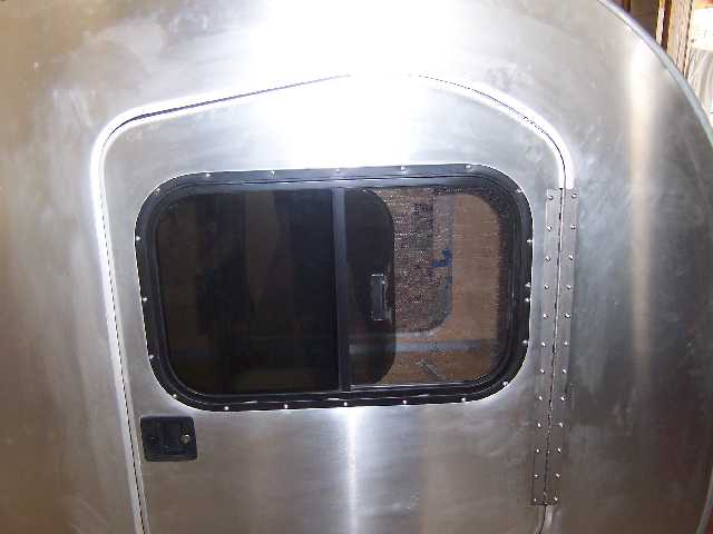

Jack...have ya bought your windows yet...if not...HOLD THE FORT...I use the same windows that TJ sells, specifically the 15x24 sliders which list for 83bucks...I buy the EXACT same window from the Exact same jobber for 62 bucks...the windows come(to TJ) from RedNeckTrailerSupply...I have a local RedNeck distributor(my welding supply) house and they charge me 62 bucks and NO SHIPPING...check with your local welding supply or weldors or utility trailer manufacturer for a local RedNeck Distibutor
madjack 8)
p.s. I don't use their inner frames...I find 'em kinda cheesy...we just drill screw holes in the outer flange of the window, apply a urethane sealer and screw them in place...we then use a little black paint on the screw heads.....MJ

RedNeck is a very large National trailer parts supplier, I don't know that they do any direct to public online sales...we have a local utility trailer mfg and a local welding suply house that are both RedNeck dist...at a savings of 20+bucks plus shipping per window, it would pay to hunt them down...interior trim will be up to you, if mounted as we did...we cut the hole out with a template and plunge router and then used the same aluminized T molding that we used on all our interior doors and edges...
