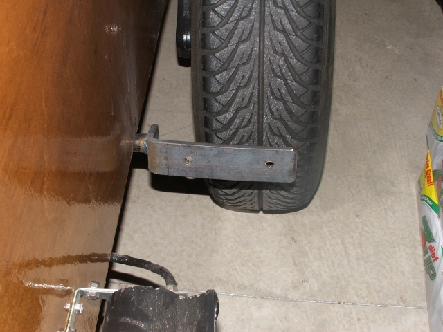

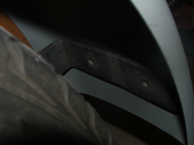

Postby bledsoe3 » Wed Mar 21, 2007 9:11 am
Mine is probably overkill but you can stand on them mounted.
The round stock is welded to the frame.

Postby Keith B » Wed Mar 21, 2007 9:14 am
Hey bledsoe3, that's nice... do they "wiggle" or do you have another attachment on the body anywhere... that looks really good.

Postby bledsoe3 » Wed Mar 21, 2007 9:39 am
Keith B wrote:Hey bledsoe3, that's nice... do they "wiggle" or do you have another attachment on the body anywhere... that looks really good.
No wiggles. The holes were drilled into the fenders so it sucked them into the body. No holes in the side of the trailer.
