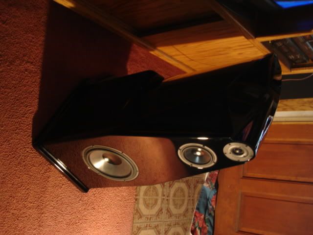

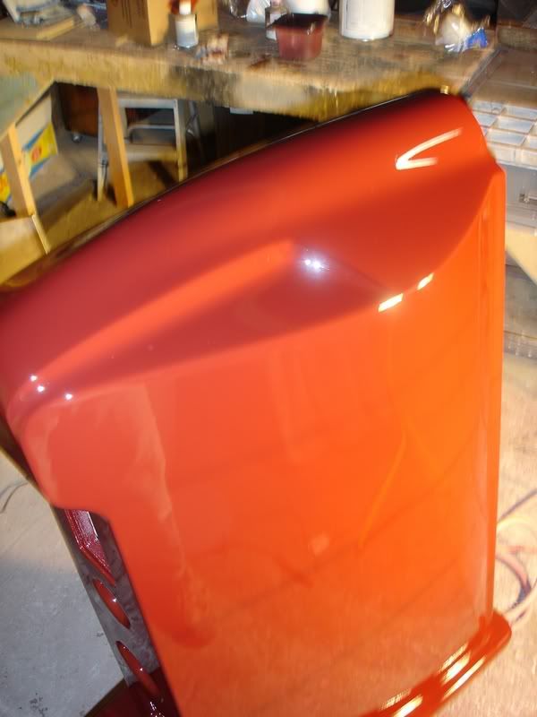

Postby Airspeed » Thu Mar 29, 2007 10:31 pm
I have done alot of painting on wood using automotive paint. It really is easier than you would think, I use alot of Nason 2K urethane,it uses a catalyst and reducer but is easy to mix. I started spraying with a Harbor freight HVLP gun and it worked fine but I eventualy bought a Sharpe Finex HVLP (about $100 on ebay new delivered),not the bst in the world but it does a very nice job of laying on a smooth paint job. after 24 hours I sand with 2000 grit paper and buff with an electric buffer using polishing compound and then finish compound. There is no reason anyone cant paint automotive paint as long as you have accsess to a decent compressor and gun. Here are some some wooden speakers I painted with Nason 2K urethane. Aaron
http://groups.msn.com/aaronsspeakers/shoebox.msnw
Imagehttp://img.photobucket.com/albums/v655/aaronhero/freshpaint016.jpg
