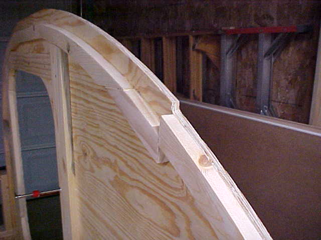

I will be starting to build the dreaded hatch and have most of the details ironed out except the sides. The sides of my trailer will be 1 3/8" thick and I will overhang the hatch sides that amount also. I want to use aluminum "L" with a weatherstrip but, dont know exactly how to bend it or even if they make aluminum this wide. Also what's the best way to attach the "L" to the hatch? I guess I could anneal the aluminum which should work but I don't want to pop rivet the "L" to the skin because this may interfere with the seal. Any suggestions would be greatly appreciated. The thickness of the hatch will be 1/8" - 1/4" thick with the skin on top of that.

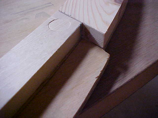

I guess the question is - how do I attach the 1 1/2" "L" to the hatch? Pop rivets will extend into the area where the weatherstrip is. I have a 3/8" notch in the side profile to account for the skin and aluminum. Here's some pics that may help.

SJ, we used pop rivets BUT we also use an insert molding with the rivets going up from the bottom, allowing us to cover the raised portion of the rivet with the insert...they make a rivet that flattens on both sides but I don't know the proper name forit(aircraft???) however it takes a special tool to install.....
