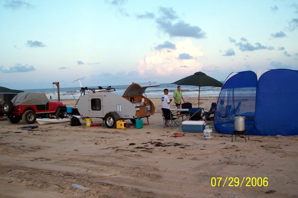

We use one of those at the beach. A 9' market umbrella, We drive a 1 1/2" pcv pipe into the sand to stick the pole in and it doesn't go anywhere.

rmcelroy wrote:Cool camping right on the beach! That looks strange to me-everwhere I camp has trees. Where do they let you do that?
Texas open beaches act. You cannot privatize any beach in Texas. If you can get there you an use it.

Postby Ira » Mon Apr 02, 2007 2:45 pm
Sonetpro wrote:
rmcelroy wrote: Sounds like we need a giant light weight umbrella right? Kinda like Caseydog.
Mc
I forgot you had that pop-up thingy room.
What's the deal with that again?
