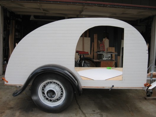

It kind of depends on how you design your trailer and if you wish to use a 4'x8' piece of plywood. Some people add a piece to create a little longer length. It really depends on what you want. My profile is based on an older style, so neither my front or back go past the trailer frame and it is cut from a 4'x8' piece of plywood. This picture is a mock up of my profile cut out of cheap 1/4" material while I was working out the profile helping me figure out what I was doing before I cut the actual plywood.
My suggestion would be to decide your profile and go from there. Many people also work with Baltic Birch plywood for their sides. Generally it comes in 5'x5' pieces, only 1/2" comes in 4'x8'. I also don't know if you plan to have just a solid piece of plywood for walls or insulate them as many outside of California do. With homebuilt trailers they all vary one from another, so it just depends on what suits you. That's part of the fun. :lol:

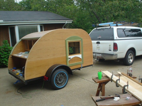

My profile is very similar to Martha's and I also used one sheet of 4' x 8' starting from the front of the trailer bed to the rear.
Hope the pics help.
