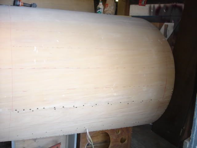

I am getting ready to skin my trailer and cant decide on aluminum thickness for the top. I am pretty sure I will use some thicker stuff for the sides because I want it to be as smooth and flat as possible but my top has a couple of fairly sharp radius. I dont know how difficult aluminum will be to bend around the front and rear curves,here is a pic of the tear. Thanks for any suggestions!

Postby Airspeed » Sun Apr 08, 2007 10:21 pm
Front, It is hard to get a side pic of my tear because I am building it in the foyer of my basement shop and I only have 16" on each side for construction, I dont even know for sure what the entire profole looks like yet! and I wont be able to see it until I cut out a post in front of the shop doors so I can pull it out of the shop. Will .04 aluminum bend around this radius or am I asking for a tough time? Thanks again! Aaron

Postby Phil & Ningning » Sun Apr 08, 2007 10:24 pm
Mine is .032. I would have used .025 if could have gotten it. There is really no need to go thicker if it is all backed with wood.
Incidently, per Cubby plan, my roof is not backed with wood, just al on the spars. Even there, .032 seems plenty.

Postby Airspeed » Sun Apr 08, 2007 10:31 pm
I am trying to imagine how easily it bends, does the .032 bend fairly easy? does it feel flimsy? I guess Im asking something so subjective that it is hard to answer but I have to travel about 100 mile to pick it up and may have to order some if it is not what I want. I just dont want to make two trips. Thanks again! Aaron

Postby sdtripper2 » Sun Apr 08, 2007 10:34 pm
Airspeed:
Aluminum sheet thickness?
For bend-ability yet strong and ease of use:
The short answer for many in the past would be .032 sides & .040" thick for roof for a sweet spot~ :)
The long answer would be below: :lol:
Aluminum Sheets
Thread will explain how to cut 103" x what ever size sheet aluminum
http://tnttt.com/viewtopic.php?t=12863
Examples of grading and sourcing of Aluminum:
The 3003-H14, 5005 & 5052-H32 aluminum sheet grades comes in 48 or
60 wide, and 96 , 120 , or 144 long.
Most prefer to use .032"-.040" thick for the walls and top if possible.
In 4 foot sizes that is very easy to find. The 5' or 60" sizes your choices are slim.
It comes down to manipulation of thicker stock that is the issue.
If anyone finds sources for .032" or .040"in 60" x 120" sizing let us know please.
For the roof the .050" is about as thin as you are going to find.
.050" 60" x 120" any thicker like .063" and people complain its heavy & hard to work.

Postby Airspeed » Sun Apr 08, 2007 10:51 pm
You say .032 for sides and the thicker .040 for the roof? am I reading that correctly? By the way ,thanks for all the info,I am sure the answer is right there but I curious about this before I go searching and learning to make sure I understand right away! Thank You Very Much!!!! Aaron

Postby sdtripper2 » Sun Apr 08, 2007 11:11 pm
Airspeed wrote:You say .032 for sides and the thicker .040 for the roof? am I reading that correctly? By the way ,thanks for all the info,I am sure the answer is right there but I curious about this before I go searching and learning to make sure I understand right away! Thank You Very Much!!!! Aaron
AAron:
The .32" & .40" is a ball park figure many here will advise on this thread.
Just note that many complain on the bending of anything thicker than 040"
for the roof. This sweet spot is an unofficial accumulated data point of many
threads and from many who have skun-da-skin so to speak.

Postby tonyj » Mon Apr 09, 2007 12:00 am
I used .032 for all of mine. It was thicker and stiffer than what I expected it would be. Lays pretty flat. You shouldn't have a problem on the front radius. The transition above your taillights might be a problem, although if it is a smoother radius than what the picture appears, you shouldn't have any problems there either.
My aluminum isn't bonded to the wood, just fastened by the trim.

Postby Airspeed » Mon Apr 09, 2007 12:18 am
Thanks, The radius above the tail lights is a little smoother than it looks but I have been thinking up ways of making a curved brake to prebend it at that point just in case. I may put a joint near that radius and use some thinner material there to get around it, I will know more when I get the material. Thanks again! Aaron

Postby tonyj » Mon Apr 09, 2007 12:24 am
You could probably lightly anneal the area right at the curve to make the bend--just don't heat too much or you'll burn through.
Just my opinion, but I would avoid putting a joint in that area if you don't have to. You don't want anything to distract the view from the beautiful lines you've designed.

Postby madjack » Mon Apr 09, 2007 12:38 am
Aaron...we use .032 on everything...once you get over .040 it starts getting harder to bend...I think the annodized would be really "tuff" lookin'...not to mention the easier maintenance of the annodized over mill finish...when skinning the hatch...I would fasten the AL at the top, lay it in place and use a couple of straps and 2x4s to force the bottom radius(one 2x4 above and one below...
madjack 8)
p.s. an Al handling warning...due to size of sheets, it is very easy to flex them while handling and put a crease in it...you will never get that crease out...also if using mill finish, try to get it with a protective plastic sheet on it...peel just enough of the sheet back to allow you to work on it...leave sheet on until all constuction is finished...mill finish AL is soft enough to scratch just from looking too hard at it..........MJ
