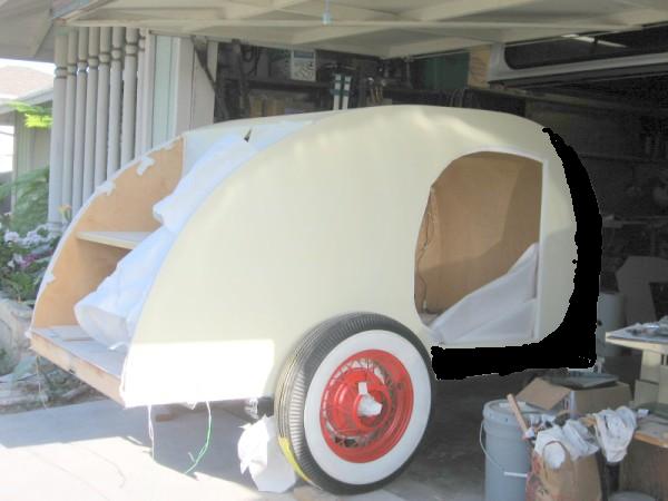

What I’m thinking is adding black detailing like the classic kit lines which would mean I need to paint the aluminum trim. Is there anything special that needs to be done in order to paint the trim? The body of the TD we’ve been painting with latex enamel.
I added some black via paint shop (I can’t do it very well) to my photo for the general idea of where the black would go on the side.
