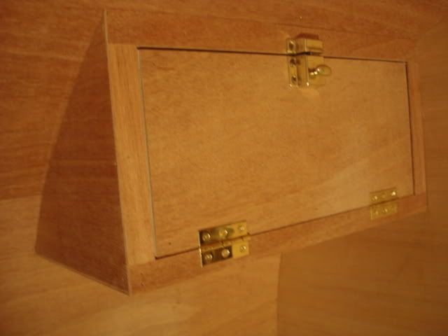

Postby Airspeed » Tue Apr 24, 2007 12:11 am

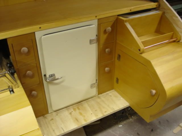

I had to reskin the interior of my cabin,I didnt like the way the 1/4" luan from Home Deport looked so I bought some really nice luan door skins from the local lumber yard and covered the interior again, I have built the two overhead cabinets in the front end of the cabin,I built two of these and will probably put a shelf in between them. I still have to spray some clear on the interior cabin area. Aaron

Postby Airspeed » Tue Apr 24, 2007 12:15 am
And here is the galley with all the knobs,hinges installed, I got the sink drain hooked up with a drain hose and put a copper towel bar/handle on the end of the sink slide to pull the sink out. now I have to find a single valved faucet to mount over the sink. Aaron

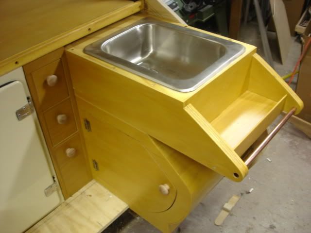

Postby Airspeed » Tue Apr 24, 2007 12:16 am
Here is the sink in the out position. Aaron

Postby Miriam C. » Tue Apr 24, 2007 12:30 am
Fantastic cabinets! I love the copper towel bar.
What does the sink slide out on. That is a neat design. I think I need to copy parts of it. 8)
Postby Airspeed » Tue Apr 24, 2007 12:40 am
The sink slides out on wooden tracks that are lined with felt,I was going to use drawer slides but I didnt really have enough room under,or on the sides of the drawer, they slide very smooth and have stops that keep them from coming out to far. Thanks!!! Aaron
