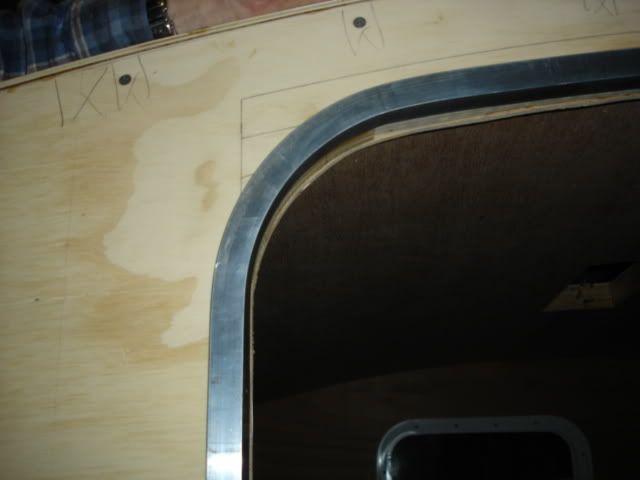

Postby Airspeed » Tue Apr 24, 2007 6:08 pm
Thanks Guys! I went down to the basement shop and annealed away.
I cant believe how easy it was! I was so intimidated by this process for so long and put it off until today. I wish I would have known how simple
it was to do,I would have made my corners even smaller. I was able to get the aluminum to smoothly bend around 4 and 6" radius on my door and wall, not a wrinkle dip,mar,nothin! It looks like a factory did it!
I would say to anyone afraid of trying it to go ahead and not worry cause it is easy!
Now I'm looking for more places on my camper to trim with aluminum! The only problem I had was when I smashed the skin on the palm of my hand between the hammer and the plywood I was tapping on
and got a nasty blood blister!
Thanks again for the links and advice!! Aaron

Postby Airspeed » Tue Apr 24, 2007 7:12 pm
Here is the trim! I aint takin the band aid off! I just put it on after my wife kissed my booboo,If I take off the bandaid I will start crying again!
Aaron

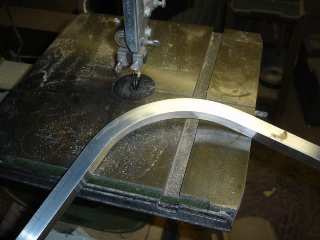

Postby Airspeed » Tue Apr 24, 2007 7:13 pm
another
