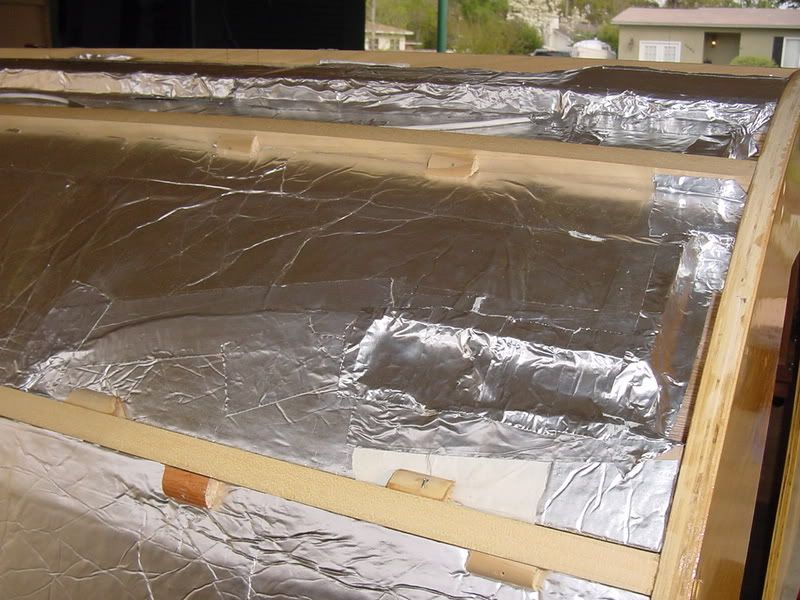

I cut mine to fit snug and just pushed it on in there. On the curved sections I used scrap quarter round to hold it in. Then used foil tape where needed.

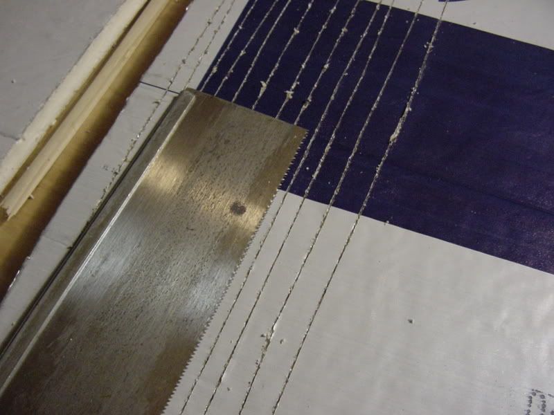

Oh, I had to cut some lines...I can not remember the term.. with a hand saw.. not very deep either, on the pieces in the curved section to help it bend.
Mk

And MaryK--the term is kerfing.
