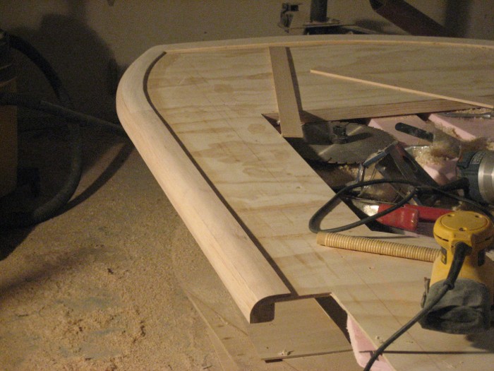

Here is the trim on the SlumberMax...1 1/2 roundover on ash.

Postby Dean in Eureka, CA » Tue May 01, 2007 1:26 am
Dave,
That trim looks awesome!!! :thumbsup:
You made some serious sawdust doin' that I'll bet.
How many passes???
Looking forward to seeing it with finish on it. :twisted:

Postby diverguy » Tue May 01, 2007 7:40 am
very nice. makes me jellious. i dont think my skills are up to that so i cheaped out and purchased my trim. i am envious 8) of the skill and beauty. great job, :thumbsup: :applause:

Postby b.bodemer » Tue May 01, 2007 8:16 am
That's going to look beautiful..................

Postby Classic Finn » Tue May 01, 2007 5:54 pm
That is indeed fancy ... :applause: :applause: :applause: Beautiful Work Done... :thumbsup: :thumbsup: :thumbsup:
I sure wish I had tools and knowledge to do that kind of fancy work..I guess a whole lot of patience is also involved..
That is Sharp..

Postby Juneaudave » Tue May 01, 2007 7:19 pm
Dean in Eureka, CA wrote:Dave,
How many passes???
It probably took 12 passes with the router!!! That ash has wanted to tear or split from the get go and didn't want to chance it. I had to take the base off my router to fit that bit. I've only used that big bit on the table before. A little antimidating for me, but kindof a fun step!!!

Postby Micro469 » Tue May 01, 2007 9:59 pm
That is really sweet.... wanna come over and do mine?? :roll:

Postby Podunkfla » Tue May 01, 2007 10:26 pm
WOW! Juneaudave... That really does look super nice. I'm afraid I would also use that big bit in a router table if at all possible. I do admire your skills to get such a fine result with a hand held router. That's gonna be a beautiful tear! :thumbsup:

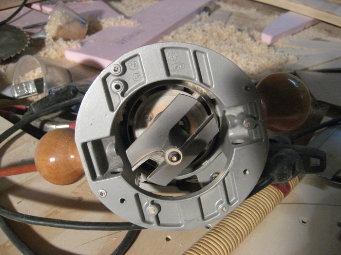

Postby Mary K » Tue May 01, 2007 10:37 pm
Hey Juneaudave!! Wow, Nice :thumbsup:
Could you get a picture of the bit for us? I'd like to see what made the trim.
Thanks, Mk

Postby Juneaudave » Tue May 01, 2007 11:07 pm
Thanks for the support...I need it...MK....Here's a picture of the router bit. It's kind of a hog, it measures 3 inches across and really ought to be in a table (as opposed to freehanding without a router plate)!!! It's scary because a false move will goof you up big time!!!

Postby Dean in Eureka, CA » Tue May 01, 2007 11:22 pm
Dave,
Can you get purple heart up there???... That would definately giva yaa the contrast, if yaa like the color of it.
How about using aniline dye on the lighter colored mahogany???
Just the picture of that bit in your router is impressive!!! :o
Betcha that baby develops some torque when you pull the trigger... :shock:
WOW!!! Twelve passes with that monster...
Looks like you're a Steddy-Eddie and have the patience of a priest. :thumbsup:
