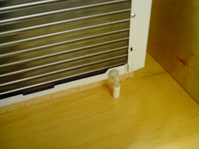

This week end and the past few days have yielded a little progress.
I got the air conditioner condensate drain installed.

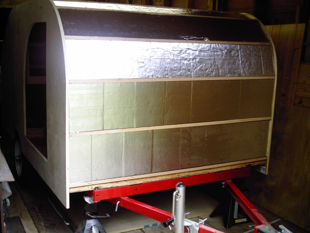

I got the insulation done. The first layer is 3/4" styrofoam and the second one is 1/2" urea foam board. Silver side out. :R

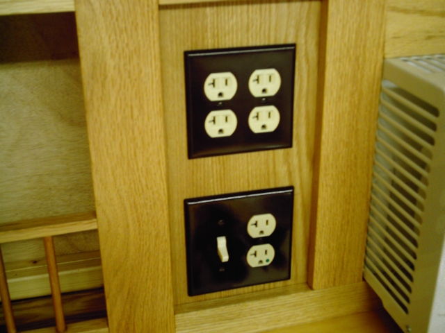

I got the main bulk of the electrical for the galley and the cabin done. :thumbsup:
On the galley, the top recepticals are shore power. The bottom one is inverter power from the battery. The switch is the 3-way type that will control the on-off of the inverter, the other side of the switch is in the cabin. I'll be able to control the inverter from inside or out. :D
Also looking at the cabin electrical the receptical on the left is shore power, this will be the AC hook up. The other one on the right is inverter power. On the top is the other side of the inverter switch. And the other is cable and phone jacks! :twisted: I don't know if I'll ever need the phone jack but I found this combo and figured I might as well run both.

:applause: :applause: :thumbsup: Great progress. A phone jack might be useful. Some campgrounds have phone and cable service. Inverter switches are a good idea too. :thumbsup:
