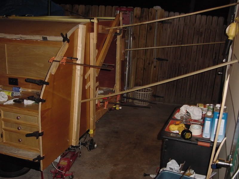

Postby Mary K » Thu May 03, 2007 9:03 pm
How you like those braces??? :lol: :lol: :lol:
Okay, Thats done... :thinking: What next?? Oh NO...Trim :(

:lol: You do have a way with clamps, uh braces. Ingenuity lives at your house for sure. Looks nice :thumbsup:

There's more than one way to skin err a... TEAR :lol:
Way to go... Mary K :thumbsup:

That's the way to use the old noodle. Looks real great. Love that clampsmanship. :thumbsup: :applause: :lol:

The orthodontist from He**!!! :shock: :shock:
OOHHHHH ... you mean those braces!!! :lol: :lol: :lol:

I can not take credit for it. When Dad comes over to help, he takes over, and I let him do his thing cause it always works.
We did the other side skin tonight and I had to turn the TD around so we could use the wall again for bracing. :lol:

:thumbsup: way togo on the ingenuity factor................... 8)

I thought that everyone put the side skins on like that. ;) BTW it looks very nice.

Way To Go Mary K.... :applause: :applause: :applause: :applause: :applause: :applause: :applause: If there is a will there is a way...Look Out Folks Cause :applause: here comes Ingenuity K... :lol: :lol: :lol:
Lookn Great. :thumbsup: :thumbsup:

Two thumbs up for your dad and his creative bracing methods. :thumbsup: :thumbsup:
