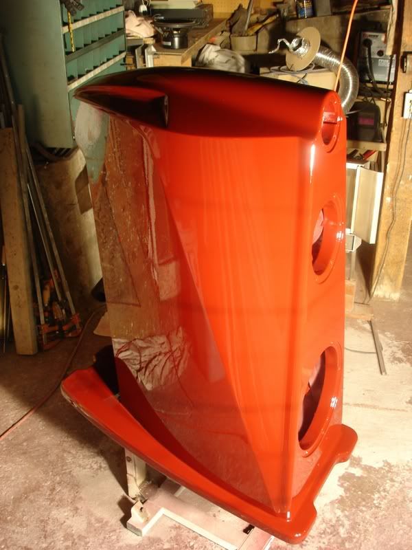

Was it you that post some time ago that you use auto urethane when painting your speakers? If so what do you do to prep them for this process they look like glass in the pics.
Sorry if I am driving my my own thread off course just taking a little detour. :oops:
The reason I ask is because after going to the DAM gathering I noticed how Smooth wood gets when covered with numerous coats of Spar varnish. I want to make my final coats with a one step auto paint to match my Scion and was wondering about prep and adhesion issues? :thinking:

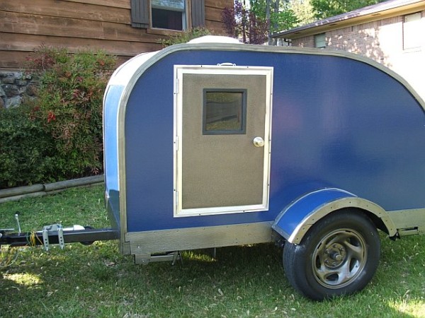

My Door is 24" Wide and 36" Tall. I weigh Around 225 and have no problems getting in and out. Matress 8" Thick.
Inside Photo
Outside Photo

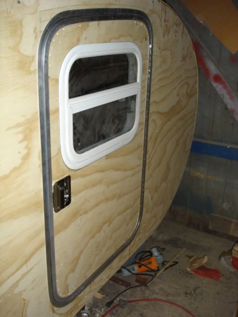

Now back to doors. Here's an inside shot.
With the door threshold being half the mattress, you'll never feel it when sitting on the mattress with your legs out the tear. It also helps to keep the mattress and bedding in and makes it easy to close the door. Oh my door measures 36" high and 32" wide or is it the other way. :thinking:

Mike, as for prep,there is allot! After I get the cabinets built I cover the entire surface with a VERY THIN layer of body filler that has been thinned with Plastik Honey, then I sand them smooth,Heat them up inside and out for about 24 hours to get all the materials to shrink up as much as possible,then I cover the entire suface again with sandable primer,heat it again,sand it spray another coat of sandable primer,heat again,sealer,wetsand down to 800 grit,paint with Nason 2K urethane or PPG depending on how much the speakers are selling for,then wetsand the paint to 1500 after about twelve hours, then I polish with polishing compound with my 7" polisher.

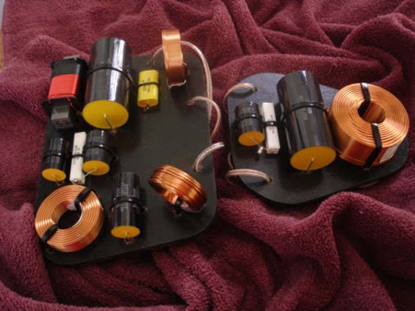

The paint takes almost as long as the speakers do to build. I design and build the crossovers as well. Need some speakers! ?
