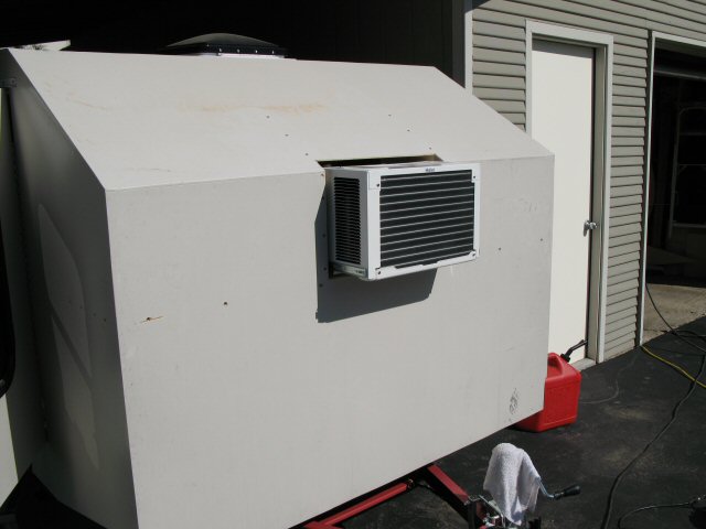

In this build I thought about installing an AC unit that slides in and out. Like the one George T did on his pop up camper. Bandit did his using sliders but there are no pics. I have PMed both but so far no response.
Pics of GeorgeT AC unit.
In George's pic it looks like you just push the unit out on these wood rails. If you don't have a lot of arm strength this could be difficult. I like his idea for simplicity but I have no way of knowing how easy this would work.

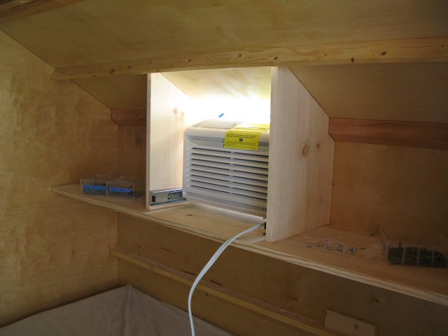

Postby mikeschn » Thu May 10, 2007 6:00 pm
I don't know if this will help, but here's a couple pics of the mod I did on the EH...

Mike thanks for the pics. It looks like you mounted the sliders to the AC. Did you have any proplems in doing it that way? I'm thinking that the distance between the two vertical walls is critical in order for the sliders to function properly. I would have attached the sliders to the AC and measured the distance from the outside edges of the sliders to get that distance. Did you do it that way or use some other method? Or do the sliders come with instructions that would give you that measurement?

Postby mikeschn » Thu May 10, 2007 6:50 pm
The sliders are 1/2" wide.
The important thing is to go wider rather than narrower...
then when you install your ac, you shim up one slide to fit...
Let me get a pic of my shim...
Mike..
Postby mikeschn » Thu May 10, 2007 7:01 pm
here ya go...
