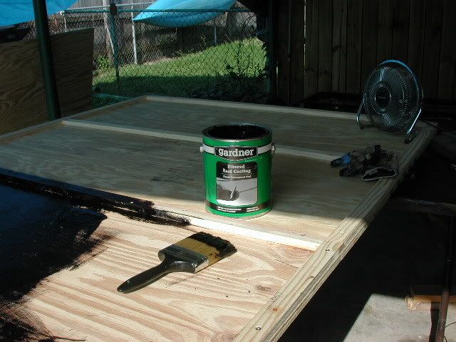

Postby Mary K » Tue May 22, 2007 10:28 am
Miriam C. wrote:Evil smelling black goo (aka fibered roofing) is cheap and works. 8) but it is messy.
Its really was not all that bad. Kind of fun actually!!!
AND CHEAP!!! $6 a Gallon Enough for 2 coats and some on the bottom of the Battery box and side wall edges. And I still have some left. By far the easiest option.
Mk
