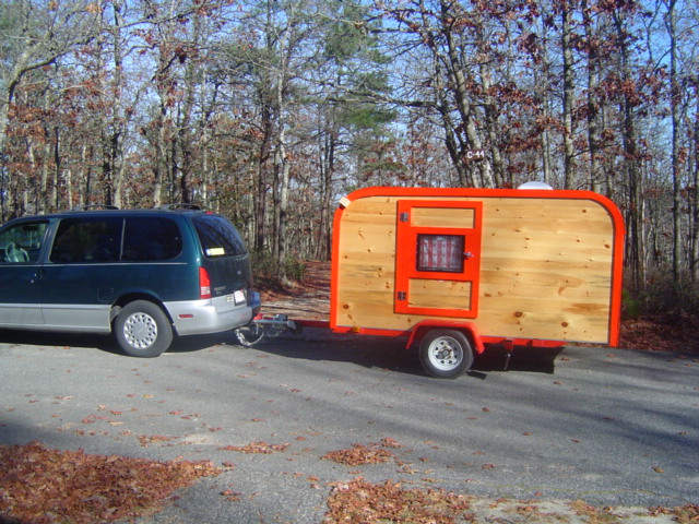

I hung the back of the trailer one foot over the floor so my galley would be deep enough. The trailer is a dumping type from HD with the axle in the center http://tnttt.com/album_ ... 15822enter.[img]
