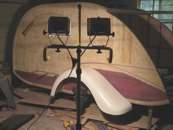

Postby Miriam C. » Sun Jun 03, 2007 1:48 pm
ummmm, how exactly is it that we have not seen this TD grace our pages?
All I can say is Image The woodwork on it is absolutely beautiful!
Postby Juneaudave » Sun Jun 03, 2007 2:01 pm
Miriam C. wrote:ummmm, how exactly is it that we have not seen this TD grace our pages?
Sorry Miriam...it's the same one I've been working on since last year!!! :oops: :oops:
I'm in a nose to nose race with Dean!!! :cry: :cry: :roll:

Postby bledsoe3 » Sun Jun 03, 2007 2:13 pm
I think you're way ahead of Dean. He's still taking things apart to redo.
