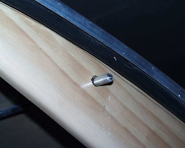

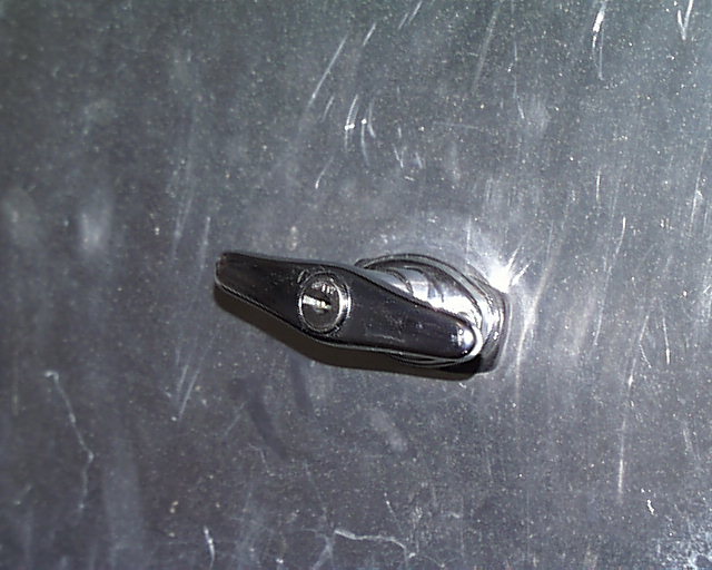

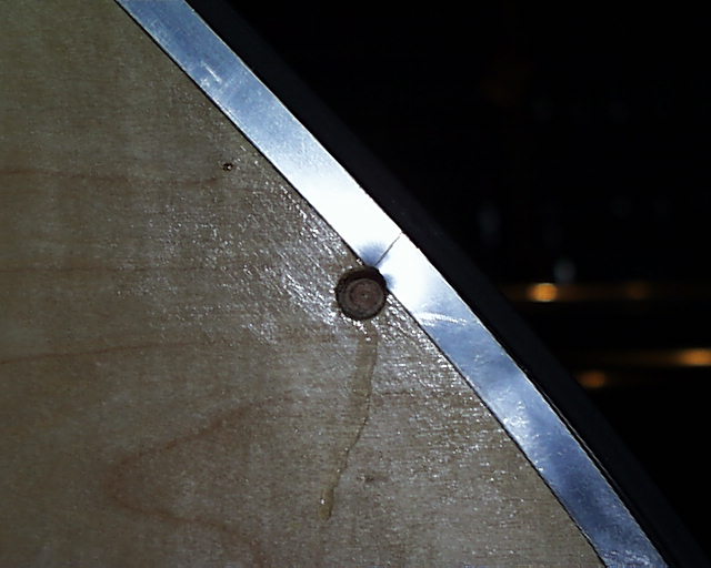

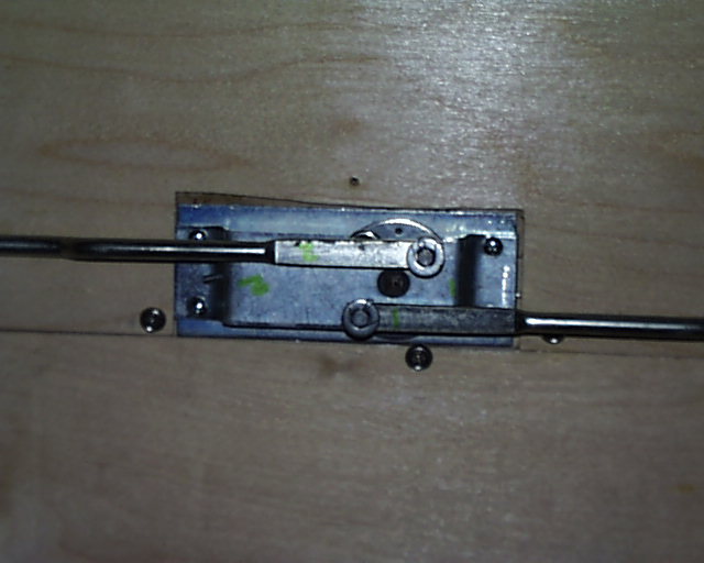

Postby s4son » Sun Jun 10, 2007 5:47 pm
Like Coop said.
I framed the hatch with two parallel cross members with blocks where the handle would be attached.
After test fitting I skinned the inside. I wanted this on the outside in case I neede to get to it.
I used ink on the end of the rods to find the location. After drilling through insert the rods. The trick is to get them flush when the latch is open but sticking through enough to latch when closed.
Next drill the coorsponding hole in the side for the rod to latch into.
After skinning the outside of the hatch install the handle.
Hope this helps. Please don't laugh at my pictures, I am neither a carpenter of a sheet metal worker. :)
Scott F.

Postby Classic Finn » Sun Jun 10, 2007 5:50 pm
s4son wrote:Like Coop said.
Scott F.
Scott thank you for the photos indeed.. dont worry I wont laugh nor judge another mans woik..I am neither a carpenter nor a locksmith...but darn I try ... :lol: :lol: :lol: Yupper these photos help me to get a good idea how its done.. :thumbsup:
Thanks Again
