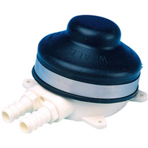

If you want pressurized water I'd add a 12-volt pump for that; it won't use much power and you'll be able to use it any time. Personally I really like the Whale foot-operated pumps because your don't have to touch faucet knobs and the water only flows when you pump. You can go through a lot of water with a pressurized system when it runs while you're busy soaping up and such. Here's the pump I like:

lblampman - I really like that foot pump! :thinking:
