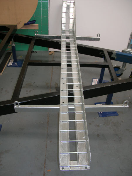

I broke out the die grinder and 4 1/2" Grinder and cut off the back 7 feet of metal mesh leaving the front 5ft mesh for my cycle to ride on. After looking at making some changes, I built a 2x4 subfloor for the floor assembly to lay on. Remember, my trailer was built with angle iron and the walls have to hang over the sides. Anywho, here is some pics of my last 7 days back on the build after taking a few months off.
I started all over again on the floor. It's built with 3/4" Sandel Ply and is 85 3/4" x 76. The above pic was taken earlier as the Asphalt Emulsion was drying. I insulated the floor with 3/4" foam insulation. I sprayed 3M Super 90 on the floor and then laid in the insulation and fastened down with 1 1/4" Screws and Fender Washers.
here's a shot of the trailer with the back 7 feet of metal mesh removed and repainted in flat black. I painted the 2x4 subfloor assembly black to match the trailer. The floor assembly will go on top of the 2x4 frame.
A little farther back view to show the true length of the trailer. I have begun to run my tail light wires.

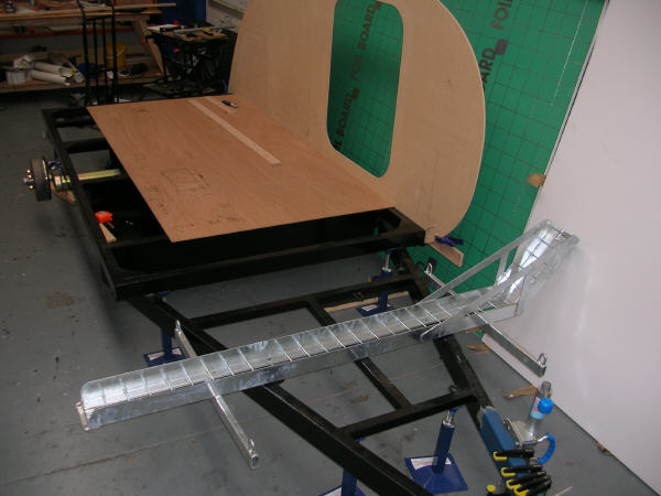

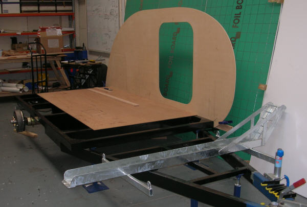

A few days ago, I was rethinking the door size and placement. The last few walls I had cut, had the doors too high off the floor and many here told me I would regret. I knew they were right so I sat down with pencil and paper and played on the graph paper until I could find a happy medium as far as placement and size of the door. I ended up going with a larger door of 26"x32". I decided to cut it where the bottom of the door was 4" off the floor to allow for the thickness of the fold up mattress I bought to go into the trailer. Since 3" of the bottom of the teardrop hang over the sides of the trailer, the door was cut 7" from the bottom of the wall and 8" from the very front of the teardrop. I figured the farther forward I placed it, the better clearence I will have with the fenders. Instead of making my own doors, I am going to cheat and take the easy way out. After all the problems, restarts, I decided to take it easy on myself and buy two of those Horse Trailer Feed Doors which are already premade. Most I have seen on the internet are 26"x32" thus the size selecton of my door cut-outs.
Another thing I figured is to heed MadJacks' advice about not making sandwiched constuction walls with insulation. Winters are not that brutal here in Tennessee so I opted to go for a much simpler design of 3/4" walls covered with carpet from front to back just like they do on Little Guy model teardrops which is what I am modelling mine after. I am NOT breaking any new ground when it comes to originality. My ability to think outside the box sucks so I am going for function over form. The sandwich construction is just another problem waiting to happen so I will just stay simple with the walls...cover them in carpet and be done with them!!!!
Anyway, I spent much of today doing the final shaping on the walls and door cut outs. Here's some pics of the progress below:
Here's the walls clamped together on the saw horses. I shaped them for about 3 hours with my belt sander and palm sander.
Here's the front of the profile showing the fresh door cut-outs.
The rear of the teardrop, the hatch area. It was still roughly shaped at this point but now it's all smooth and even to the best of my abilities.

Postby sandman » Thu Jun 14, 2007 2:31 pm
Well, I went and did it!!!!!!!!!! Yep, after 3 more hours of tediously sanding the profiles, I finally got them somewhat close. As soon as you flip them over on the other sides, I kept seeing unevenness all over the place. You can NEVER get two walls identical no matter how hard you try. The last thing I noticed after flipping the walls over bookmatching them up, the door cutouts look bigger on one piece....I just said to hell with it...I'll worry about that later. I don't know how you other guys built these things without loosing your ever-loving mind.
Anyway, I beat back the demons once again and decided to go ahead and mount the driver's side wall permanently. I drilled the holes 6" apart and went back with the countersink bit and carved out the screw holes. After all that, I took a deep breath, smoked a cig, stood back and thought long and hard before cutting open the fresh tube of Liquid Nails Extreme Duty Construction Adhesive. I put out the smoke, cut the tip off, loaded the tube into my caulking gun and held my breath as I laid a big bead on the side of the floor. I got to the end of the floor, walked back to the front and laid down another bead on the lower part of the floor side. After getting it all over my hands, I quickly wiped them off, grabbed the wall and laid it into place. I quickly drove in the front and rear screws to hold the wall in place and then went down the side driving in the 2 1/2" Exterior Screws. Each screw that went in caused more and more adhesive to ooze out of the unfilled screw holes. The squeeze out got bigger and bigger as I worked my way to the rear. With Liquid Nails you don't have a lot of time to dilly dally before it begins to set up. I got the last of the exterior screws in place and then grabbed the right angle jigs I had made a few months back. I quickly screw one end of the jig into the floor at the front and the back and then clamped the upper part of the jig to the walls.
By the time I had finished this, the adhesive that had oozed out had begun to set up so I believe I did it in time. Anyway, the first wall is now drying in place. There is NO turning back now. Here's some pics of this morning's work:
Driver's side wall glued and screwed in place with right angle jigs holding them square to the floor.
Front view of the wall with the jigs in place. Lord I hope it dries square to the floor! :?
Just a pic from another angle. Does it look like a teardrop yet? :lol:
A nice rear shot of the now permanent wall.
