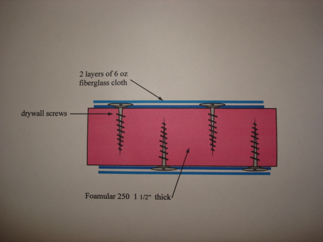

Here's an illustration of my proposed topper cross-section.
I'd love for you guys to tell me why it won't work. Any ideas to make it work?

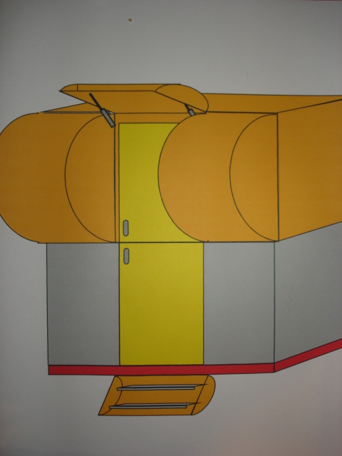

Here is a drawing of the proposed pop-up in the up position (repost.)
I've decided to do away with the side door to improve it's structural integrity. Instead I will use a rear entry (no porn jokes please), with a 26" wide hatch: the bottom of the rear apex droping down, forming steps, and the top hinging upwards on struts in classic TD fashion. Sort of like entering a flying saucer. The a/c will also be relocated to the bow of this land yaght, attached to the 5'x12' inner bottom and above a tongue mounted, horizontal l/p tank. The bottom will be a more conventional, foamular-core, wood-framed build. The only twist will be that it'll be mounted on an aluminum trailer with the 3' high sides framed in aluminum angle and strapping for rigidity.

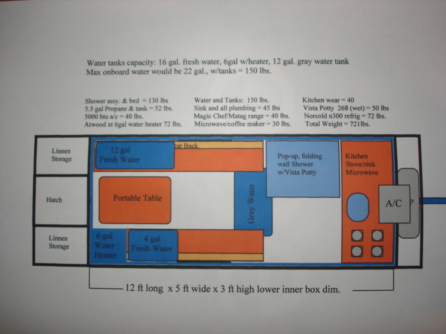

The only thing I see is that with the AC / LP and the kitchen all up front your tong weight is going to be very high. It maybe as high a 50% of the trailer, could be even more than that with the ultra light body. :thinking:

One thing you must do is check your assumptions, which seem to be that styrofoam with glass and epoxy will be lighter and stronger than plywood and styrofoam or urethane foam. Such is not the case. A year and a half ago I spoke with Larry Steeves who owns http://www.raka.com, a glass and epoxy house that many of the folk on this board use. Larry said that pound for pound plywood is the strongest material available for the intended purpose. You can check this forum for comparative weights since they have been posted before.

Thanks for your reply and the insulation link. I've searched the forum, but haven't found anyone using an ultra-lightweight frameless, foam only body. I'm a noobie, so I might have missed the posts, but if you've got some links, I'd love to check them out.
I must have got some bad information. Let me run the numbers by you so you can check my math.
First, lets look at the weight of the lightest plywood available.
A 4x8 sheet of 1/8" okoume weighs 19lbs (19lbs/32sqft = .59lbs/sq ft.)
I have roughly 500sqft to cover (both inside and out) with plywood .59 x 500 = 295lbs. Add framing, glue, fasteners and insulation for another 50lbs = 345lb topper.
According to this link: http://boatdesign.net/forums/attachment ... 1126213824
Each layer of 7oz cloth cured at a 50/50 ratio with epoxy is .104lbs/sqft x 500sqft = 52lbs. x 2 layers = 104lbs +53lbs of 1.5" foamular 250 and 3lbs of screws = 160lbs., for a net savings of 185 lbs.
Now I have no doubt that the framed plywood laminate will be much stronger than the glass covered foam, especially at the thickness I'll be using. I won't need this extra strength, as my lower box will provide sufficient strength/stiffness. I'm just using the glass for encapuslation, relying on the structural integrity of the foam simply to support it's own weight and to provide rigidity. Remember this is not the actual body, just a topper. It will be supported by a strong, metal framed inner structure while traveling down the road. Others have made similar structures from simply tentage, or stretched cloth over a spruce frame (like a lightwieght aircraft canopy.)
My primary goal is light weight. I would consider the sealed and painted glued-up EPS alone if I thought it would survive, but I'm afraid that without some type of encapsulation it would come apart under the vibration and stresses of the road. I have considered a simple epoxied canvas covering as well, but I thought the fiberglass cloth would make it a little stronger.

To help you better understand my dilema, here's a recent drawing of my proposed floorplan. Any advise on how to further lighten my TD will be greatly appreciated.

sushidog wrote:Each layer of 7oz cloth cured at a 50/50 ratio with epoxy is .104lbs/sqft x 500sqft = 52lbs. x 2 layers = 104lbs +53lbs of 1.5" foamular 250 and 3lbs of screws = 160lbs., for a net savings of 185 lbs.
A 50/50 ratio of glass to epoxy is appropriate for a vacuum-bagged laminate in a expert shop conditions. For a first-timer working with contact moulding, a 33/67 ratio would be more realistic. So that would add 50% to the laminate weight in your calculation.
It's still much lighter than the ply option, but then two layers of 7oz cloth is pretty thin - it will be strong enough not to fall apart but you ought to make yourself a test panel to see if you think it's 'tough' enough, particularly for stone impacts while towing.

The profile is and older version when I was considering a side door. I think you're right about the excess tongue weight. The a/c must be moved to the front or positioned in the starboard side (over the axle) like A-liner does. I could also position the water heater and/or propane tank over the axle directly opposite the a/c under the sofa/seat (port side.) I have since decided to go with a rear entry for structural rigidity of the long axis to resist flexing of the lower walls, which could bind the topper.
Here is a drawing from the rear perspective. My wife couldn't crawl in through a small hatch either (I'm not sure if I could), so I'm using a full door (2 seperate pieces - one on top and one on bottom, that swing together like the A-liner's door)
