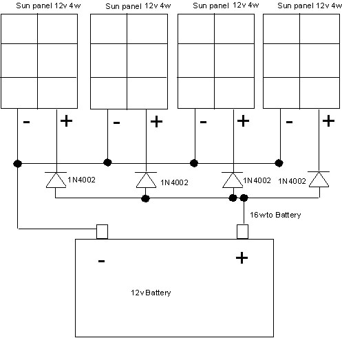

Postby Chuck Craven » Wed Jun 13, 2007 9:09 pm
Get 4 of them and wire them in parallel with a 1-amp 200v diode between the panels. The diode will keep the panel from trying to back charge the other panel. The diodes just isolate each panel from each outer. You will get 16 watts of charging in full sun that is 1 amp hour, not bad for $40 bucks. :)

Postby Chuck Craven » Wed Jun 13, 2007 10:09 pm
Here is a diagram!
