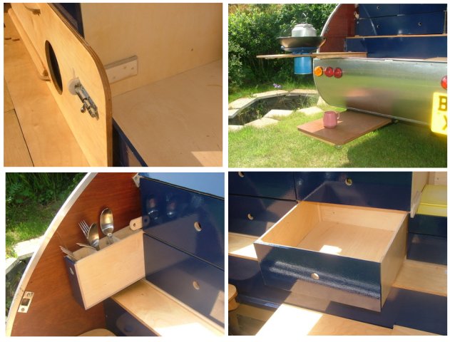

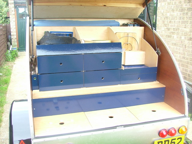

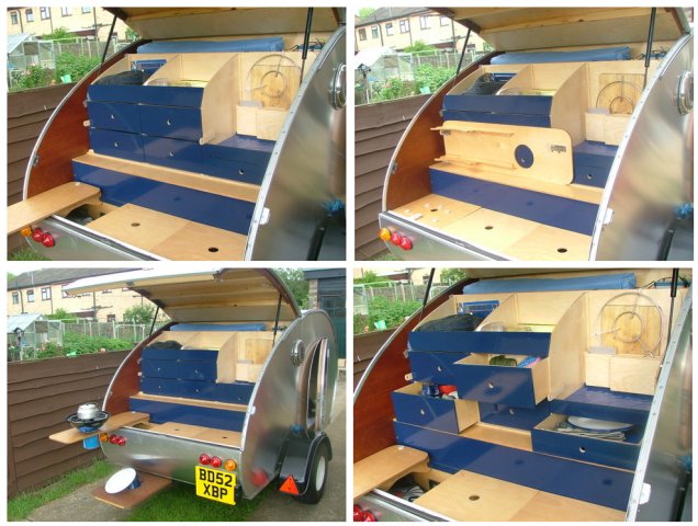

Finally my TD gets a Kitchen, well more of a breakfast bar.
Design notes
We eat out mostly so I only need a standby cooking capacity.
But I want to store food, drink and kitchen paper,
I don’t have a lot of space in back. So I made the draws to keep them slender for max capacity.
The cooker-table doubles as a way of keeping the doors closed when moving.
When I welded the frame I put some runners underneath. At the time I did not know what to do with them but look an extra shelf and it pulls out all the way to make a low (low) table.
The paint ‘orange pealed’ so I will flat it off in the close season and re-paint.
There are three bottle holders built in, 2 wine, 1 water.
Because my kitchen came later, I made it on the bench and slotted it in so its separate and can come out.
I made my self a little cool box out of the same wood and leftover Styrofoam.
Its had one trip out so far and it all worked well.
Thanks to all the people who I stole ideas off, Clive

Postby steve wolverton » Fri Jun 15, 2007 4:08 pm
That little table is slick! :thumbsup: The upper table.
Do you not hit the low one with your shins? Are they called shins in England?
I don't see how you guys can pull off all that storage in the tears. That's very impressive!

Postby UK-Corlett » Fri Jun 15, 2007 5:58 pm
Hi,
Steve wolverton
No you don't bang your chin. It makes a great plate drying place.
khutson
I think the kitchen has taken as much desgn time as the rest of the TD
Hi Heikki
Thanks for the support, again.
No I don't have any pictures of the inside. But I am currently fitting a roof vent and will post picss of that and I guess there will be inside shots. You could do with a wide angle les but I don't have one. I will ask around.
