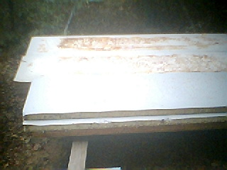

I'm using steel to clad my trailer with. I know it is heavy; but I'm using sandwich wall construction to lighten the overall weight.
Image. I know it is a poor quality picture but you can get the idea.
And yes they are insulated door blanks from french doors cut out for the windows. You can stand on one of them accross 48" spaced 4x4's on the ground. Try an Insulated door??? You get the idea.

I bought my bare steel sheets in 48" x 96" 24 Ga and 48" x 120" 20 Ga locally. At a recycler ( seconds ). In the picture in my above post are steel on the panels ( 24 Ga 20"or 22" wide x 64" or 80" long on both sides of the panels ) I use them where I can and recycle all the scrap I do not use to get some of my money back. :thumbsup:

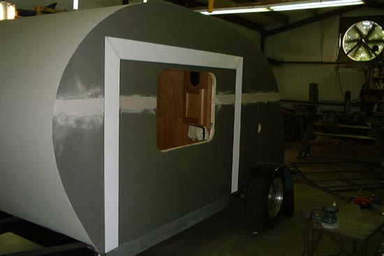

Postby Coca Cola Teardrop » Thu Jun 21, 2007 7:11 am
Aaron, We are using steel on the exterior of the slide out tear. You can see in the pic that Charles is preparing the seam with bondo for it's paint job. It will be painted to match my truck. We purchased from our local "pipe and steel" friend. It is already colored but we want it to match the truck.
Charles said he will never use it again on a teardrop. It is tricky to handle because of weight and easily dings or creases while working with it.
