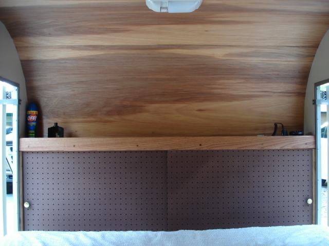

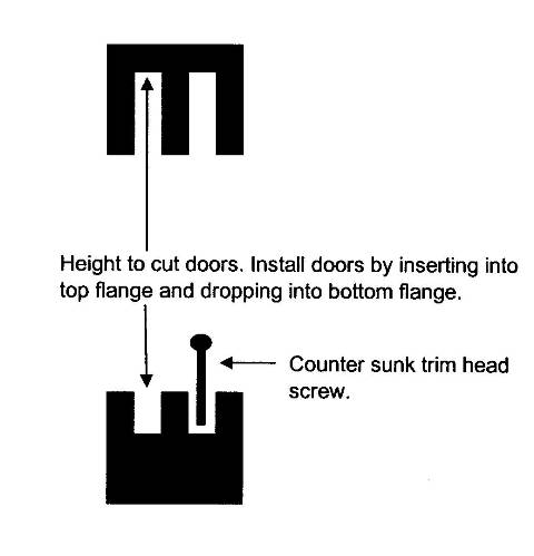

See my album... I built some sliding bypass doors up front. The material is 1" wide and 3/4 thick. I cut the grove w/ a dado blade. The 1" was only so I could put the screws on the inside and you wouldn't see them, however, you can get whats called a trim head screw and they will fit down inside the dado grove itself. I used 1/8 hardboard (peg board) for doors...gives ventilation for the converter, etc. that's behind the doors. The top board should have a deeper grove than the bottom by about 1/4"; then you cut your doors the distance from the inside of the top grove to the top of the board on the bottom...they will not jump out...well, mine didn't anyway.
I'll try to draw a layout and post it for you.

Postby Keith B » Wed Jun 20, 2007 10:20 am
Here ya go:
Trim Head Screw:

Keith I really like what youve done with them cabinets... :thumbsup: Great looking tear..
One thing I noticed was the ceiling ply.. What is that? Is it Birch? Or is it somthing else?

Hey thanks yall...yeah, the pegboard was laying around, but even so, it's only about $8 a sheet and I needed ventilation for the converter. I also used 1/4" hardboard (without the holes) for the galley cabients... Eventually I will finish the galley out with raised panel doors but this was what I had laying round and figured if anything did leak or I didn't like the layout I would be out VERY minimal $..... they actually work quite well and the stuff lays FLAT and you can still put a nice bevel on it with a router... it was ugly, but more importantly, it was functional and that's all I needed for the first outing. The ceiling is 36x72 door skins ($6)...cheap and easy, with 2 coats of Watco Danish Oil.. no poly.. I tend to go for the VERY natual look in wood - I use lots of oil.. danish, tongue, etc. For "water-proofing" outside furniture I use regular 'ole vegetable oil, repels water like a dream...when it dries out, gets a scratch, whatever, just wipe another coat on and you'll never notice it; that's also what I use for finishing out cutting boards - TiteBond II and vegetable oil are both FDA approved for cutting boards.
