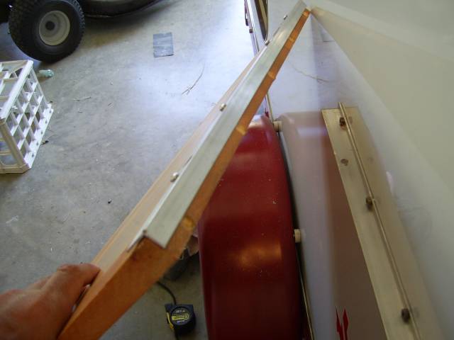

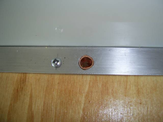

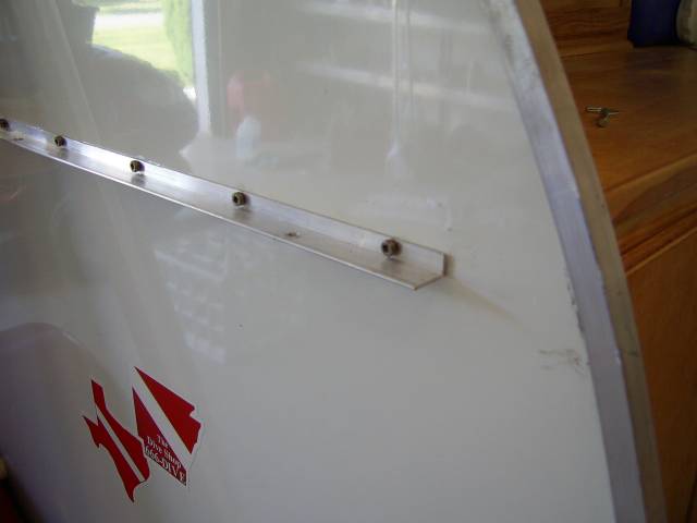

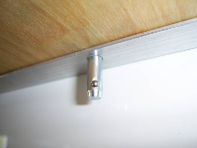

i made mine myself from two pieces of 3/8 alum angle. one piece mounted to the camper and one mounted to the the table. two hole and some 1/4 pins. here are a couple of photos.

Nice setup Diverguy :thumbsup:
You can find the premade supports at www.go-rv.com ... look here. The 30" section (2 pieces) is $6.39 retail. One side fastens to the trailer the other to the table end and then they nest together; pretty neat setup.
