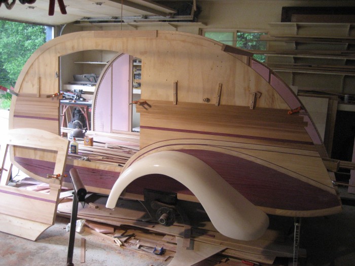

Postby Juneaudave » Sat Jun 23, 2007 12:36 am
What wood for a woody???? Oohhhh...I don't know...maybe oak, ash, red cedar, yellow cedar, purple heart...whatever you have laying around :lol: :lol: :lol:

Postby Steve_Cox » Sat Jun 23, 2007 7:48 am
Dave,
Very inspiring picture :thumbsup:
Steve
Steve_Cox
Posts: 4903
Images: 196
Postby doug hodder » Sat Jun 23, 2007 9:20 am
Fantastic work Dave!!! Doug
