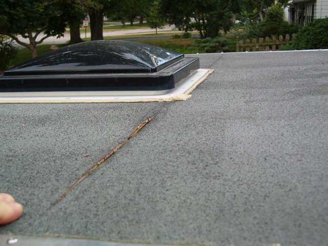

Yesterday I went to unload the TD after getting back for a 4 day camping trip with the kids and went to go wash it and this is what I found.
Not sure why or how...used a lot of glue...what I thought was good wood...my only thought was the sealing ability of Duraback on the wood.
Any other thoughts?
My TD will have a nice little aluminum trim piece on the top now.

Postby Mary K » Wed Jun 27, 2007 8:32 am
:frightened: :frightened: Yup, Elmo, That will make ones butt pucker. :o
That goes to show you, it only take one little bitty spot for water to penetrate and start its havoc.
Any other signs of leakage?
:thinking: I would trim out all seams if I were you.

Postby elmo » Wed Jun 27, 2007 8:34 am
That is the only exposed seam...the other on is safely tucked and sealed under the diamond plate in the front. I am going to get a hold of Duraback and check on painting over the top.
No leaks or water damage...other than the water I sprayed up there before I attempted hitting it with the soap. It wasn't there when I left the campground.

Postby Keith B » Wed Jun 27, 2007 10:02 am

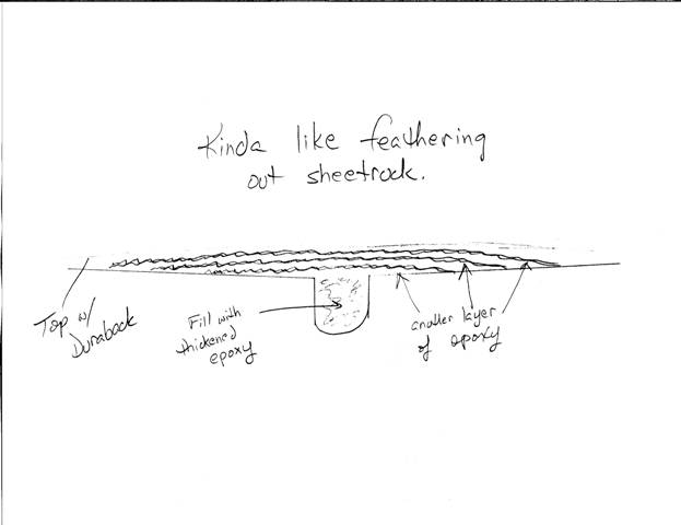

Elmo... so so so sorry to see the mess... yeah, that would lead one to have a bad day. :( Is this "water" or "heat" expansion? Was it hot when you went camping? Another option might be: remove your roof vent, use a router and straight edge and dado out a grove/strip along the seam and sand back the duraback an few 5-6 inches on both sides. Fill the void with epoxy, a couple coats put on over a couple days, and feather it back into the sanded area, let it cure for 4-6 days, lightly sand w/ 80grit for some good "grip" and then reapply the duraback for a transparent fix.
If it's "water" cut out all the ply that shows evidence of moisture and "cap" with epoxy, or it will just keep seperating. I'd try this before you spend a bunch of time and money on aluminum, etc.; you have a router and you have some Duraback, maybe try just investing in a little "time" right now. You may have had just a little pin hole in the duraback or something. Did you seal the wood prior to applying the Duraback?
Man, I'm terribly sorry about the mess; I hope you get 'er fixed and can keep on enjoying.

Postby elmo » Wed Jun 27, 2007 10:19 am
Keith B wrote:Elmo... so so so sorry to see the mess... yeah, that would lead one to have a bad day. :( Is this "water" or "heat" expansion? Was it hot when you went camping? Another option might be: remove your roof vent, use a router and straight edge and dado out a grove/strip along the seam and sand back the duraback an few 5-6 inches on both sides. Fill the void with epoxy, a couple coats put on over a couple days, and feather it back into the sanded area, let it cure for 4-6 days, lightly sand w/ 80grit for some good "grip" and then reapply the duraback for a transparent fix.
I believe it is heat...doesn't look like any water damage. I pulled it back a little and all was dry underneath. It has been 85-90 and humid the last couple of weeks...no rain.
Didn't seal the wood, because I wanted to follow the Duraback instructions exactly. I actually put extra Duraback on the seams. The seams also had bondo to fill the crack, and I don't believe water would crack it, but expansion would.
Oh well...how does the saying go about crying over spilt milk?

Postby Miriam C. » Wed Jun 27, 2007 11:35 am
or maybe missing bondo. Is the bondo still there? Looks like maybe the bondo cracked or went flying like some old cauk
Postby apratt » Wed Jun 27, 2007 11:50 am
Elmo, there is your problem. Bondo has zero structurial strength. Putting bondo on a straight seam is a no no, a soon as the wood flex the bondo will crack. Sorry to see that happen to you. :(

Postby elmo » Wed Jun 27, 2007 11:57 am
apratt wrote:Elmo, there is your problem. Bondo has zero structurial strength. Putting bondo on a straight seam is a no no, a soon as the wood flex the bondo will crack. Sorry to see that happen to you. :(
Now you tell me...I never said I knew what I was doing. I could of swore people used bondo for seams!
