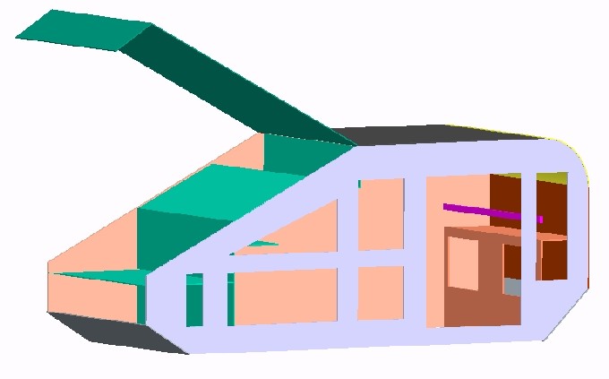

Postby draksig » Fri Jun 29, 2007 12:23 pm
Here is a rough draft of what I have in mind. I drew this in ProE.
This is just a rough, first idea. The general outline is what I wanted, the exact size and locaiton of the hatch and design of the kitchen is up in the air.
The side facing you has a door and cutouts for saving weight and insulation. The other side will have the same but is not shown here.

Postby MrBuzz » Fri Jun 29, 2007 1:19 pm
Welcome to trailer building...and all the engineering questions that come with it!
I built my Generic Benroy around the same idea that you mention...keeping it simple and getting it finished so you can use it. After talking to a few people on the forum about how to do the walls I went with the solid 3/4" plywood. It makes a very sturdy wall and you can attach interior shelves/dividers directly to it. I like the idea of the sandwich wall but by the time you build the outer wall/inner frame/interior wall I don't think you will save much weight and when you really think about how you will use the camper the 3/4" of insulation might not be worth the extra work. (That's what they make quilts and girlfriends for, eh?) On top of that sandwich walls take away some interior room. A big issue is that they add tremendously to your build time.
I'm glad I went with the solid plywood wall because it helped get my TD finished in a reasonable time frame. The walls are so sturdy that f I do another 8-footer I would be tempted to use 5/8 or 1/2 plywood to save a little weight.
Good Luck!!

Postby draksig » Fri Jun 29, 2007 1:38 pm
I had thought about that also, plus a 5000 btu AC unit is overkill for 4x8x4 so insulation is probably not required.
Also rethinking stretching the lengh and keeping it at 8' insted of 10'. THat wold elinimate the angles on the bottom and make it straight.
What did you do for the ceiling in yours? Solid plywood or did you use studs (whatever they call them in this use) and skin it?
