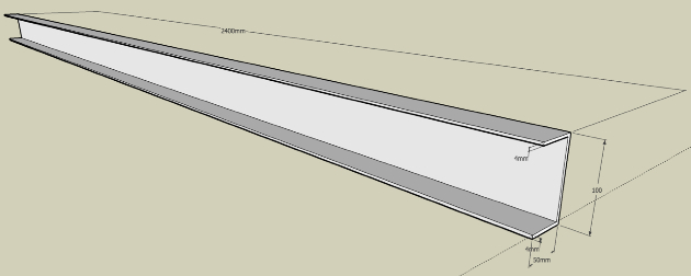

Not to mention the growing pains that go with learning something new. I experienced some of those this morning, when it took over an hour to get this created. It's actually 2 Rectangles Push/Pulled into the right size. One is inside the other. Creating the first beam of my trailer frame. :)
I think I found the VCB ( sometimes ). It's at the bottom right of the window. I found it easier and quicker to use the Dimension Tool to tell me the measurement of the piece. And then use the Push/Pull tool to make the shape the right size. Using the Orbit, Pan & Zoom tools to make the target easier to see.
