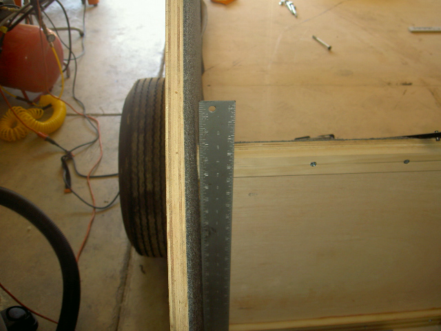

Hey Guys,
Just in case nobody see's my post about this mornings disaster. I test fit my completed Lower Bulkhead Assembly and now my walls are out of square almost 1/2". I am not sure how this could be considering I went back and triple measured all my roof spars and bulkead assembly and found them all to be a perfect 76" wide. I am kind of at a loss as to how I can get my trailer back square. Luckily, the bulkhead was not glued up yet so I can still remove it easily.
I put the wheels back on my trailer and lowered it onto the ground so everything is sitting on level ground. Is there a chance I may need to remove some width from my 76" wide bulkhead????? Not sure how to proceed. I am Trying not to panic but this has got me stumped. :? :? :? :?
Here's the pic showing the BAD THING.
HELP!!!!! :(

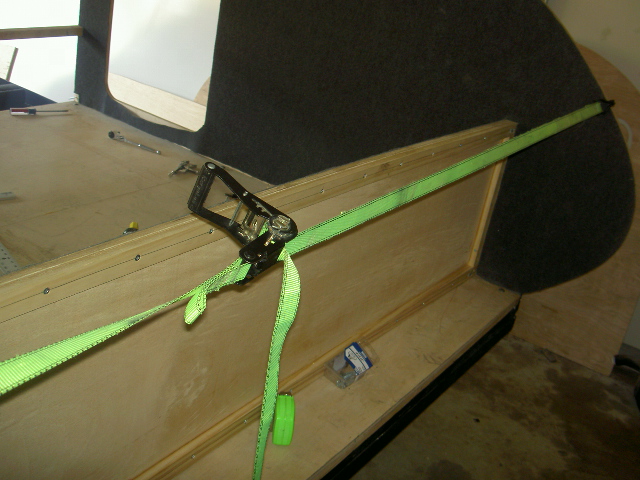

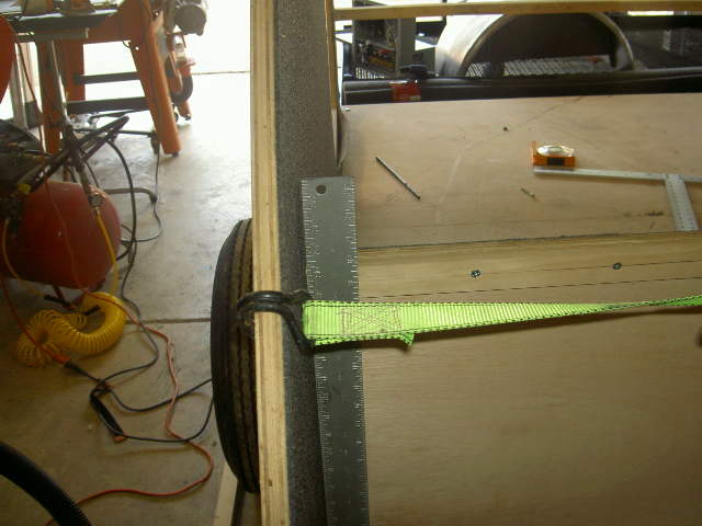

Postby sandman » Sun Jul 22, 2007 4:13 pm
I took the Teardrop only off the stands this morning whenever the Bulkhead wall was installed and I noticed the wall was crooked. I took the Bulkhead out and it had no effect on the wall at all so the Bulkhead is not the culprit. I trimmed the carpet wider and reinstalled and put 4 screws in....Again, no change. I took out the last spar and repositioned it and even installed a 2x4 spar for the hatch and still no change.
I took my tie down, put it on the very back of the tear where there were no spars and cranked it tight, the wall squared up some but not all the way. I am afraid I have goofed again. I left the wheels off and kept the trailer on jackstands since starting over with only today being the first time I put the wheels on and let the trailer sit on the ground hoping that would fix the crooked wall.
I double checked floor width, spar length, and everything is checking out. The passenger side wall is fine and square. I just don't get it.
Here's a tie down cranked down hard pulling the wall somewhat in line but still no dice.
Better but as soon as I release the tie down, the wall quickly pulls back out of line again.
Well, do I quit now????
