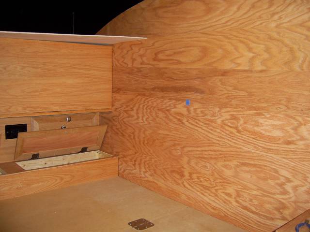

here is the wall from the inside

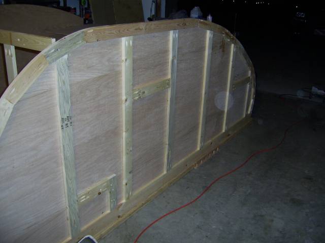

here is the full wall from the outside. odd but can you see the orbs. i often think i have a ghost in my house. doors open.

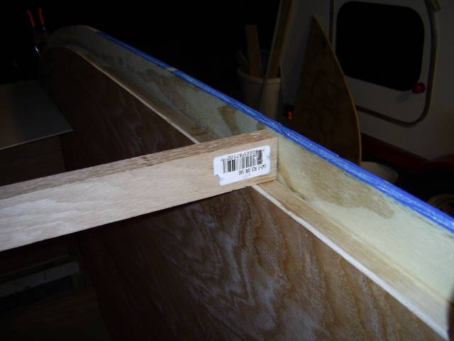

here is the wall with the exterrior wall clamped. you can see a piece that represents a spar. the celing will be underneith. this is like Steve Frederics design.

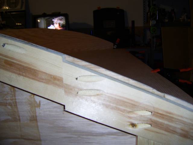

i struggled with my hatch seal design. here i have created a channel. my seal will sit in it between the inside and ousidewall. this will be my major seal and i will have a minor seal at the edge between the hatch rim and the outside wall.
so far so good. taking it slow but ths was the first time i have tried out my wall on the camper. one very minor adjustment and everywhere i checked it was square. i placed about three screws to hold in place and it was VERY strong and sturdy. i have pushed and leaned on it and it barely moves. I am very happy with this build so far.

Your ghosts are dust particles magnified by the camera. Try taking a picture at a dirt track with a digital camera, you'll get lots of ghosts! 8) :lol: :lol:

yea i know the orbs were the dust, but i was watching a pretty freaky episode of ghost hunters and then that popped on my photo.
